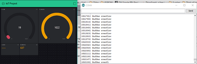

Hello everyone, … i have a project to control selenoid valve to make an irgation system using moisture senso and arduino pro mini with esp8266 as shield. it can be monitoring using gauge and controlled by widget button. and the problem is when i hit play button it working just a 5-8 second and then the notification come up and said “your arduino pro mini is disconected”. after that it will reconect again but and in 5-7 second it will disconected again. on my esp8266 i see the blue led blinking until notification came adn stop blinking
But when i dont open blynk apps and hit the play button and i watch blink led on esp it never stop blinking
and look normally

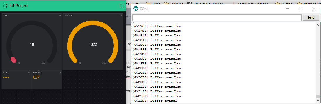

my serial monitor and it come like this when i dont hit play button
my serial monitor and it come like this when i hit play button

Edited : It’s working right now, it’s my bad,i have ro use reading frequency to fast (500ms). and also maybe my internect conection not good to reach the server blynk, assuming with ping hit 4xxxms. so i will deploy local server to see maybe it will be more responcsive.

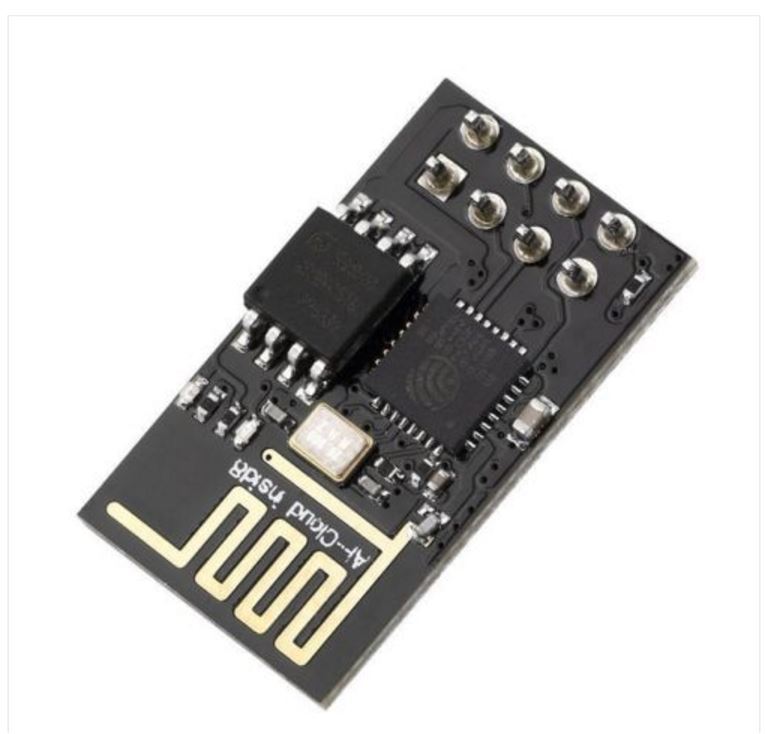

As of now i have ESP01 which doesnt have ADC, and has only a couple of GPIO pins… I would definitely go for ESPs that have many more features…

@sinet666 the ESP01 does have ADC, you just need to have a steady hand when you solder the connection.

This little buddy is pre-soldered, need to order a stand alone ESP12… Hope you understand now.
Thanks.
I know the ESP01’s are pre-soldered, I was just pointing out that you CAN enable the ADC on the ESP-01 chip by soldering your own connection.

You will need strong soldering skills to achieve the ADC pin in the Esp-01. Keep in mind the ADC only converts voltage between 0 and 1 volt. You will need a Voltage Divider to work properly with it
