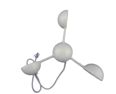

Wind speed sensors like this:
aren’t expensive.
I’ve made a weather station using this type of sensor and it’s fairly easy to do. Each rotation of the anemometer produces a number of pulses from a reed switch (two pulses per revolution from memory). You just count the pulses using an external interrupt routine and calculate how many you’ve received over a given period of time.
