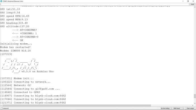

However, when I tried to obtain a GPS coordinates as well as connecting to the Blynk server in the same sketch, it doesn’t work. I can see from the serial monitor that the GPS coordinates have been extracted, also it has connected to GPRS, but the problem is that it is stuck at Blynk.begin(auth, modem, apn, user, pass); and it will not connect to the blynk-cloud.com server. I am using the latest version of Blynk. Does anyone know what the issue might be?

Does anyone have any clue cause this is really frustrating :persevere:

I notice it does connect successfully most of the time (e.g, I can see hardware connected in the blynk app) but something is causing it to disconnect again almost immediately.
Every so often I get ‘[3000559] Ready (ping: 1137ms).’ However, this is shortly followed by another connection attempt.
Lots of ‘Unhandled’ visible when TinyGSM debug is enabled. e.g:
[43316] <[02|00|01|00] #authtoken#
[44384] Cmd error
### Unhandled: ERR
or
### Unhandled: DATA ACCEPT:1,37
however, I don’t know if these are relevant? Would be great to get some suggestions for debugging this.
