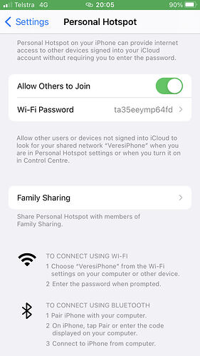

Not progressing beyond this message tells us that you aren’t managing to connect to the WiFi hotspot.
Post a screenshot of your hotspot setup screen.
Is this the one? There doesn’t seem to be much information here.
Yes, that’s what I wanted. Just wanted to check that the credentials you are using are correct.

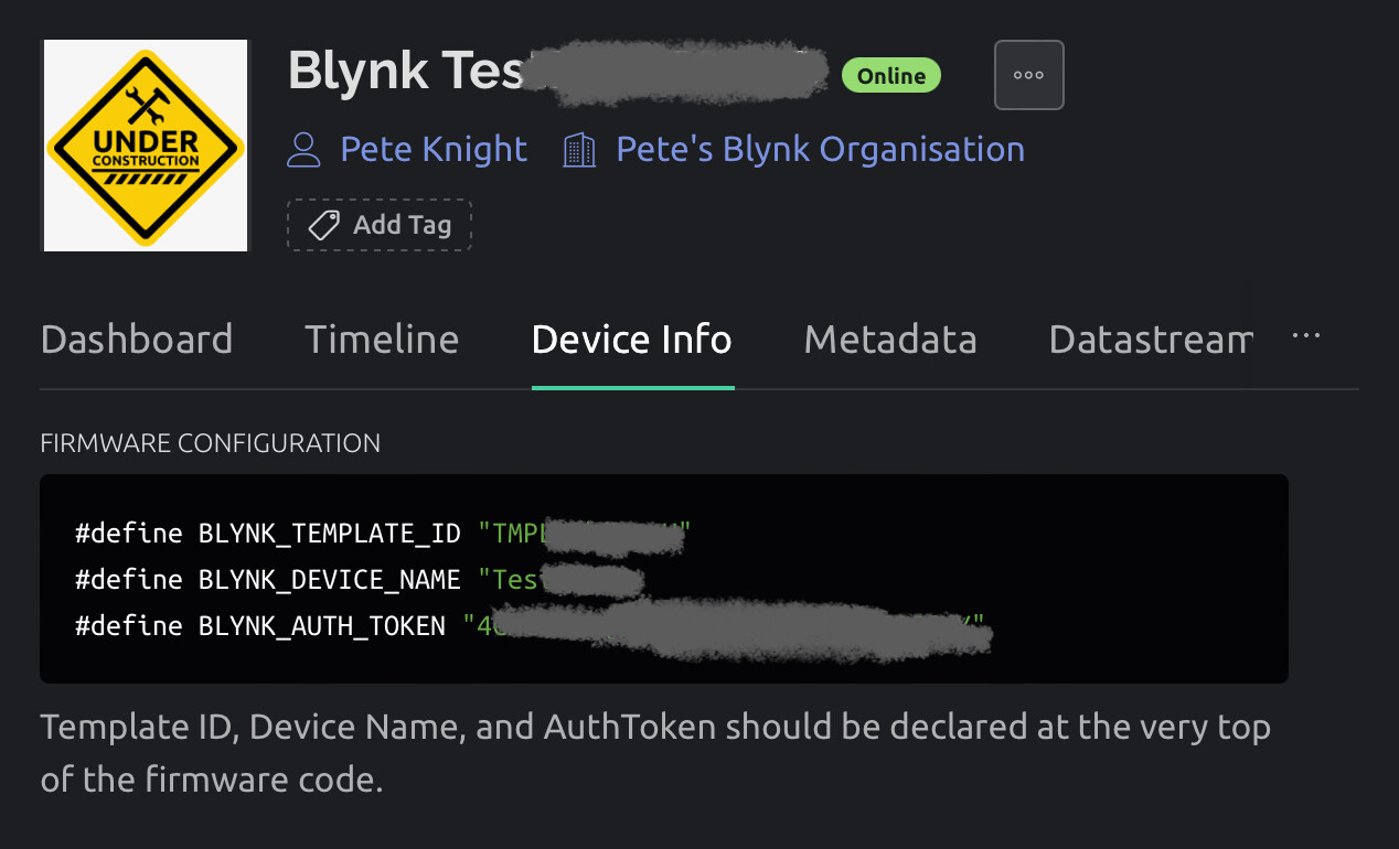

I have made some progress.
It seems that the token I am using was generated when I was using Quickstart,
presumably once you generate a token that way, it has to be used with the appropriate TEMPLATE ID
even when using sketch that came from elsewhere (in this case from examples in the Blynk library)

The Template ID, Device Name and Auth Token should be copied and pasted from the device screen…
You can’t mix and match Auth token from different templates.
