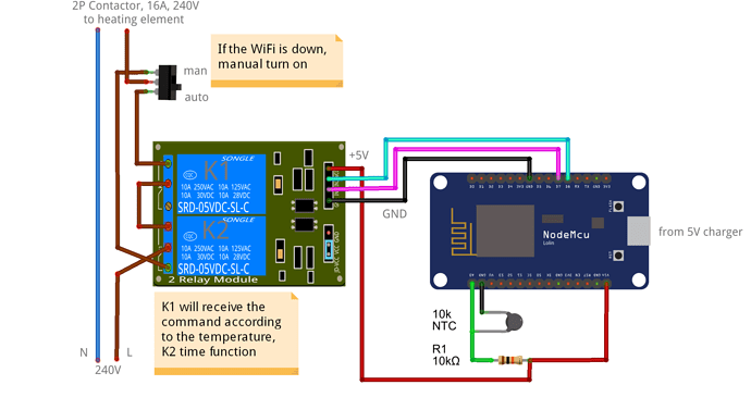

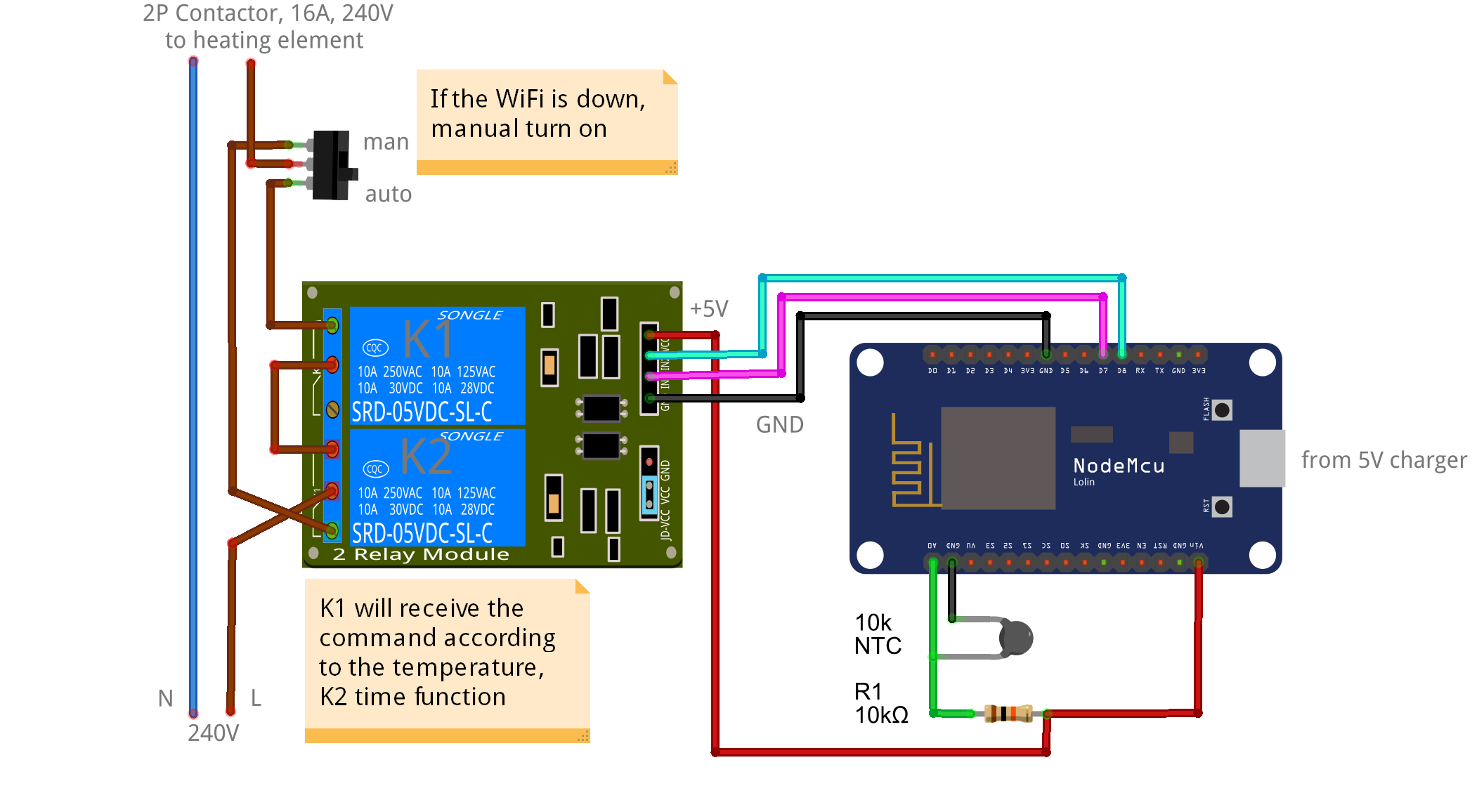

I have the same issue whit Eventor for programmable thermostat. (controlling a relay within a time frame depending on the temperature)
Because I do not know the coding part enough, I found a simple solution, not necessarily elegant and economical, using two relays (5V). A relay will receive the command according to the temperature, the other time function. The output of the relays will be connected in series, so the control to the heating element depends on the temperature and the desired time.
