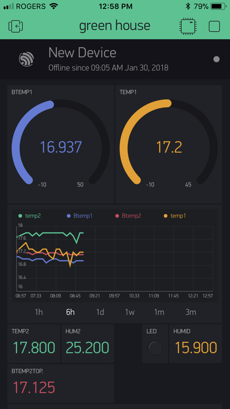

Hi I’m monitoring a greenhouse and for the most part it is working great. Unfortunately I can’t figure out why it goes offline for a period of time. No pattern, sometimes it will be fine for weeks, other times days. Most of the time it will reconnect after an few hours again but not always the case. Below is my code, I apologize if it is messy I’ve compiled it together from others.

I thought it might have been a distance issue with wifi but I have brought it inside for the winter and it is still doing it. Here you can see it has been offline since this morning. I’ll upload another pic once it reconnects. If I reset my esp it will reconnect as well.
