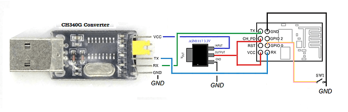

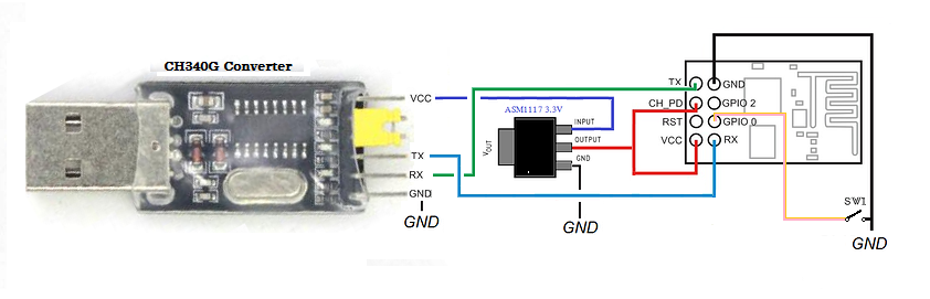

Ok doki… in this case, make your life a little bit easier… Buy an USB to TTL converter like this for 0.50€
And do this Schematics:
This way you will be able to Flash your ESP with the AT firmware to use it as Shield or directly as Standalone.
