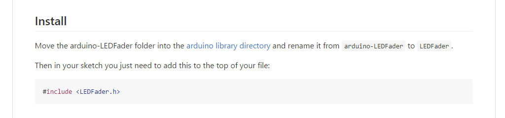

The library is NOT installed correctly… go back and read :wink:

C:\Users\Андрей\Documents\Arduino\libraries\LEDFader\Curve.h:11:26: fatal error: avr/pgmspace.h: No such file or directory
