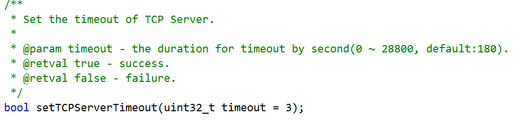

I use esp8266 with arduino mega and used hardware serial connected to tx0 and rx0 reverse the connection few times
&& modified ESP8266_Hardser.h as follw for tcp time out connection and worked fine…
