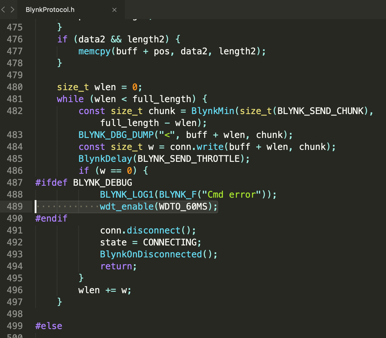

I use Atmega2560 + ESP8266(12E) Combination, Before explain what I said here.
I spend 6months to solve this problem, I read relates article who face problem like me.
  1. Different Source Volatge ( Mega 5v , ESP8266 3.3v)
  2. Set the Logic Level converter between Mega2560 and ESP8266
  3. Using HardwareSerial (Mega use Serial1)
  4. Using cleary in loop()
    5.Using BlynkTimer to check connection and if disconnection in now i inser tried code to reconnection
Sometimtimees It is works well, But I face to problem which after 2days or 5days or 6hours, after random times. Mega2560 and ESP8266 not works.(Even I set the Blynk timer with softwarereset with 1 hour interval- this blynktimer “timeout” function not works. I think Something infinite loop running in Blynk functions).
I inspect with “#define BLYNK_DEBUG_ALL Serial”, I can find the problem. I can montoring this problem from serial monitor. Some blynk function hangs with inifite loop.
1.Serial monitor print first “Cmd error”. And they print “Cmd Skipped:20”.
2.Finally they print some characters infinitely.
3. this infinite printing hangs Atmega2560+ESP8266. I Monitoring this serial monitor, this print not ends.
My solution is,
  1. Find “Cmd error” parts in BlynkProtocol.h
  2. insert “wdt_enable(WDTO_60MS);”- software reset functions. I intend If Atmega2560 suffer any “Cmd error” problem, Reset MCU.
I think it is not best practice, but It looks seem like working well.
But I want not reset MCU. I want if I take “Cmd error”, I want disconnection and reconnection to blynk server. Does any people have a best practice?

Yes, I inspect 2 origins which problem makes.
  1. Absolutley this problem caused when I push On/Off in my blynk app on smart phones.(Very fasts.)
  2. Seconds Even I not push On/Off buttons, Sometimes Hangs this parts.(After 2days, 4days, randomly.)
As you mentioned, I will trying solve to problem first caused. But I need best practice to solve problem hangs. Do you have any solution to Disconnection/Reconnection Blynk when suffer “Cmd error”, “Cmd skipped” without software reset?
