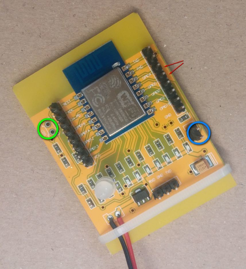

I’m using this ESP 12, which is quite common. I stumbled across the same issue, namely that the label for GPIO4 and GPIO5 (red arrows) are exchanged. GPIO4 is actually 5 and vice versa.
Apart from that it’s a nice board… it comes with a 7333-A voltage regulator (thus you can attach up to 15 V directly to the board), it has a jumper to enable flashing (though it does not put GPIO15 low, which I need to do when flashing with arduino) and it normaly features an analog optic sensor (green circle, removed it) a RGB LED (GPIO12, 13, 15) for quick testing…
So, the problem is in the board itself… right?
