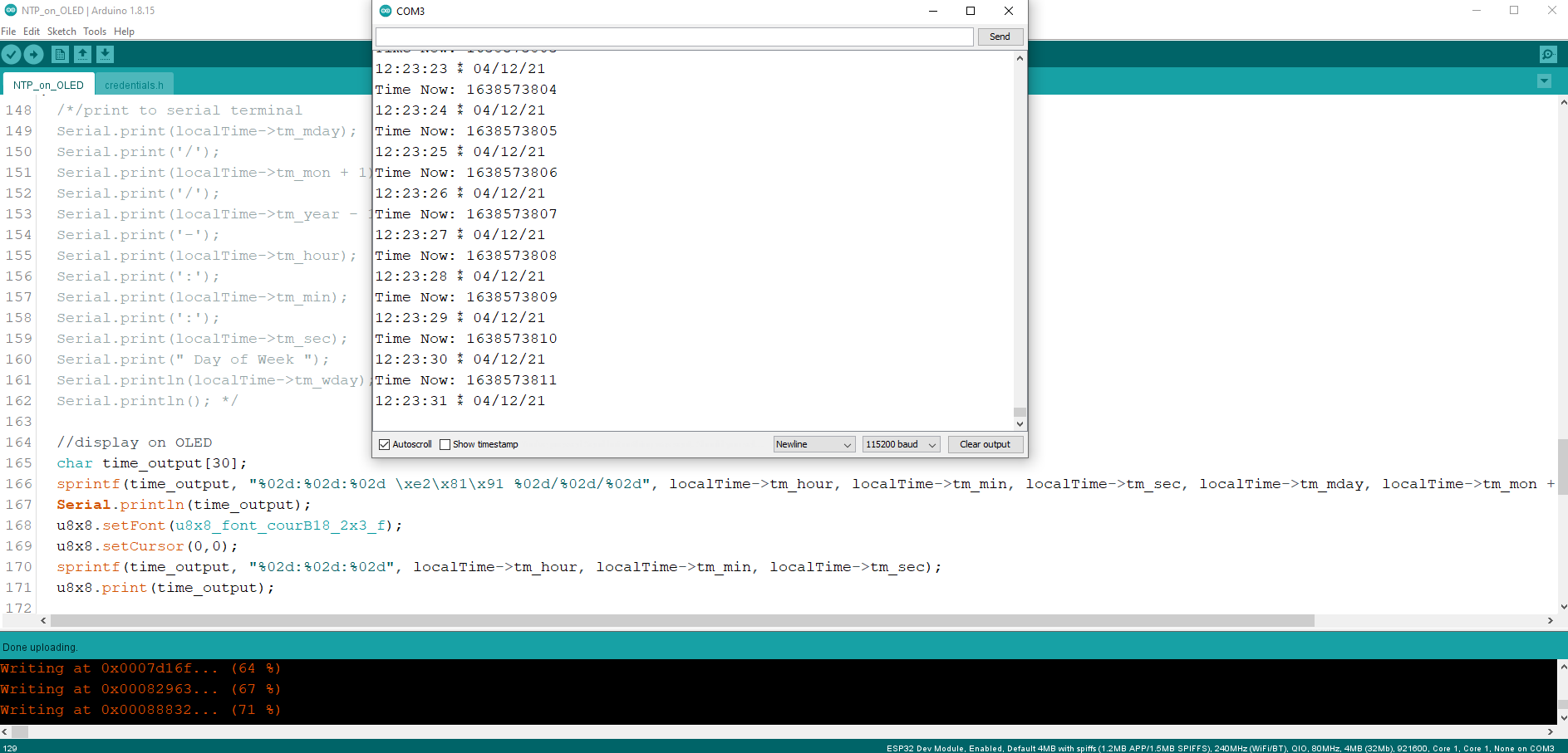

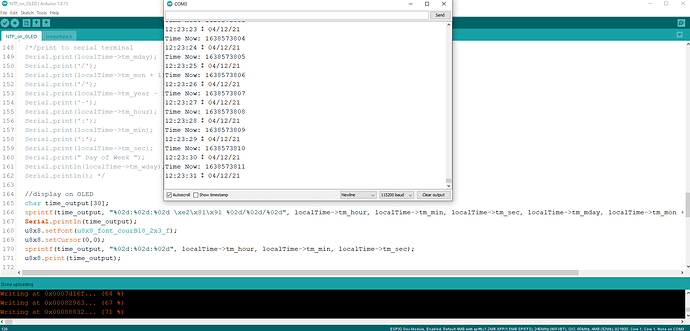

@PeteKnight and @Juraj Just in case you are interested I have just done an experiment with the same ESP32 and using sprintf with unicode separators with an NTP Time sketch.
While it’s well above my pay-grade this result suggests one of the Blynk libraries is the problem as the NTP sketch runs fine as does the Blynk ESP8266 version.
Seems I need to retarct this statement, I’ve managed to crash the ESP32 with complex sprintf statement (one int 2 x strings) in a non-Blynk sketch. Simplified things to “Serial.printf” and it all worked. So it seems its a bug/limitation in the ESP32 firmware.
