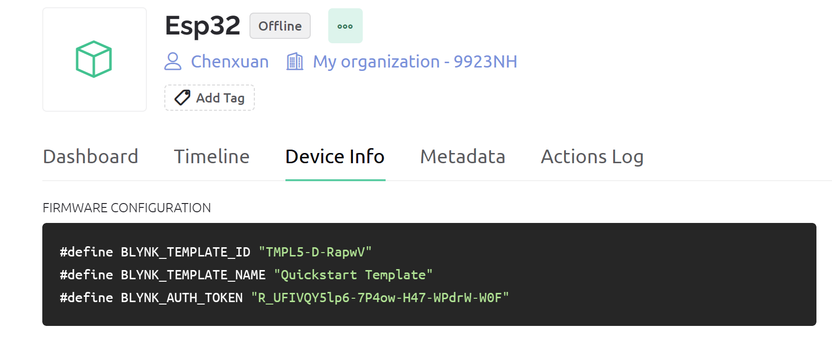

I use arduino to upload the code, the library has been installed and the output shows connecting to xxxwifi, but it still shows offline on blynk website.
/* Fill in information from Blynk Device Info here */
#define BLYNK_TEMPLATE_ID "TMPL5-D-RapwV"
#define BLYNK_TEMPLATE_NAME "Quickstart Template"
#define BLYNK_AUTH_TOKEN "R_UFIVQY5lp6-7P4ow-H47-WPdrW-W0F"
#include <WiFi.h>
#include <WiFiClient.h>
#include <BlynkSimpleEsp32.h>
char ssid[] = "ASK4 Wireless";
char pass[] = "";
Blynk.begin(BLYNK_AUTH_TOKEN, ssid, pass);

I am really confused that it can connect to wifi successfully everytime, but the templet always says offline
besides, that is all serial ouput shows I can see.
this message says “connecting”, not connected…
Your WiFi credentials appear to be incorrect…
but it is an openwifi, so there is no password
Is your SSID correct (this is case-sensitive).
sure, i compeletely copy from settings
Well, that’s where your problem lies. Maybe the space in the SSID is causing an issue?
