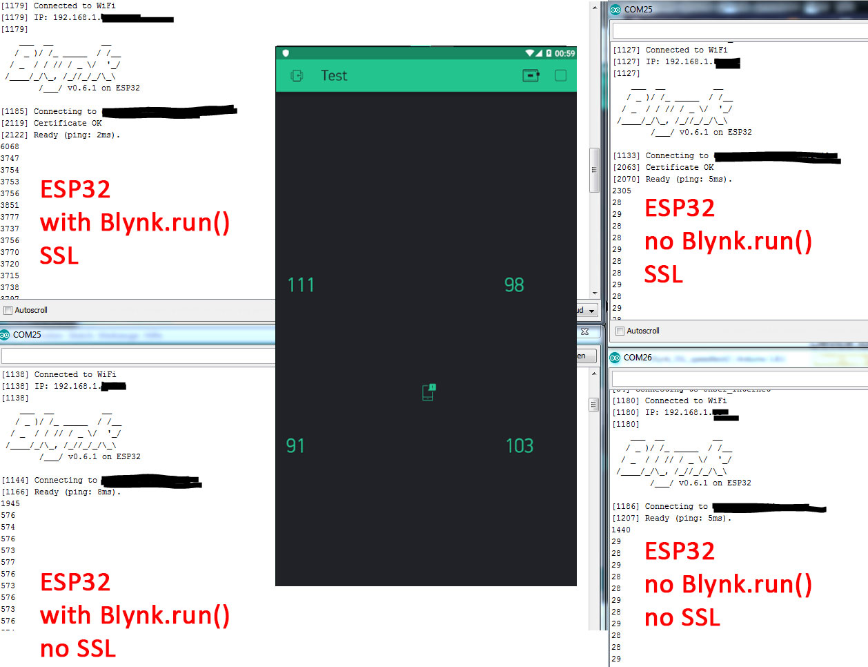

If I have a look at the SerialMonitor, I get values about 9-11 (ms) from the ESP8266 NodeMCU V3 while the ESP32 only gives me 43-48 (ms) with sometime very slow ~120 (ms) every 5 seconds.

There is no option availible for the ESP32, but the flash frequency is set to 80MHz.

Is the SSL communication the reason, why the ESP32 is so much slower - even if it should be faster?

Some peculiarity with the ESP32 library?? (and NO, it is NOT anywhere else in the code… there is just a single Blynk command in the SimpleTimer based timed display loop…)
