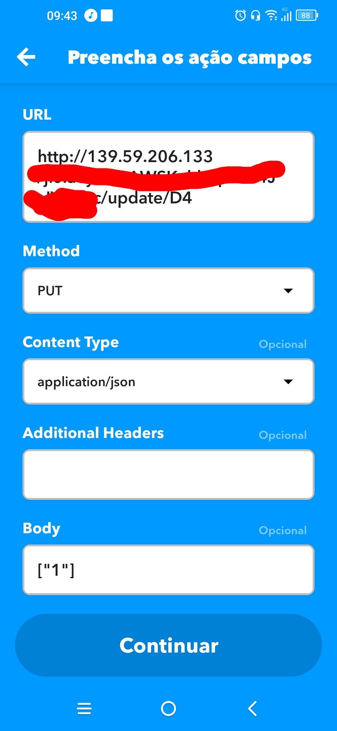

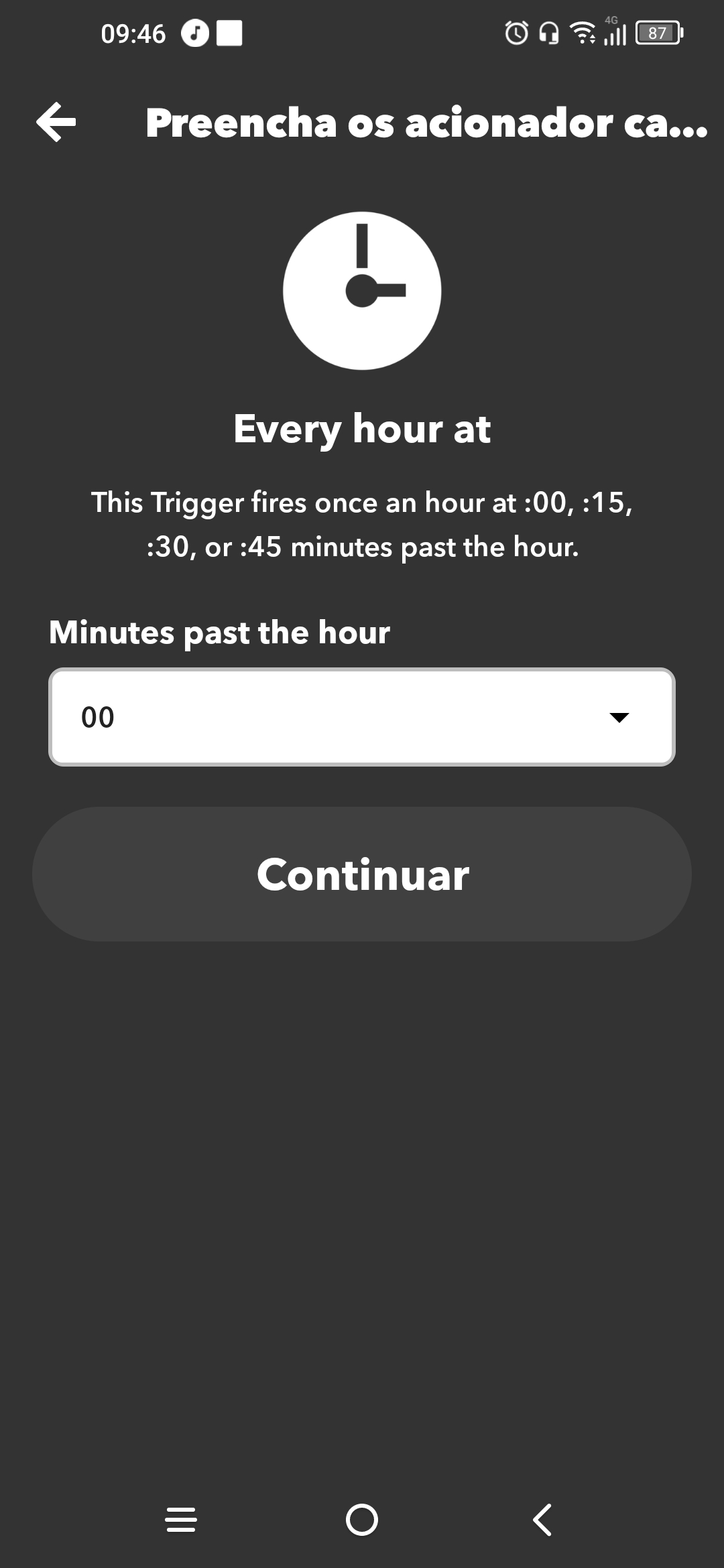

How did you configure your IFTTT applet ?
The date and time +webhook, the date and time configured at every hour at 00, the webhook os the blue image on the gif on the creation of the post, and with Pete comentary, i think i AM using the wrong IP because i was pinging the blynk-cloud.com and not blynk.cloud
Post a screenshot
this IP is the old One, the new One for my country is 159.65.55.83
If you’ve read the documentation I linked to then you’ll see that you shouldn’t be using the IP address, you should be using the blynk.cloud url plus the region subdomain prefix
Sorry i misses that parte, só in the webhook it bem like https://lon1.blynk.cloud/auth/update/D4 or it has some diference?
You should use GET method instead of PUT, and the url should look like this sample
https://blynk.cloud/external/api/update?token=ffujYGgbf805tgsf&v1=100
there’s no need to use IFTTT, you can use the new blynk automation to create a time based actions.
what are you trying to say is to create an automation time based, i am in that process, but it has one option for one time a day, the objective is to encourage to drink more water, but it can be used to other things thats a fact, it have one option to do it multiple times or i need to stick with only 1 time a day?edit:
Don’t you think that it would be sensible to use the “Wait, then do something” option?
