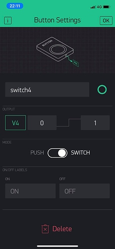

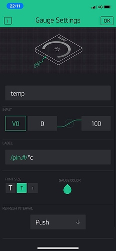

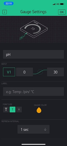

@Yok_Wuttipong please edit your post, using the pencil icon at the bottom, and add triple backticks at the beginning and end of your code so that it displays correctly.
thank you . Now it’s work right?
And… Bother you help check my code and how I fix it or where code it wrong.
thank you so much.

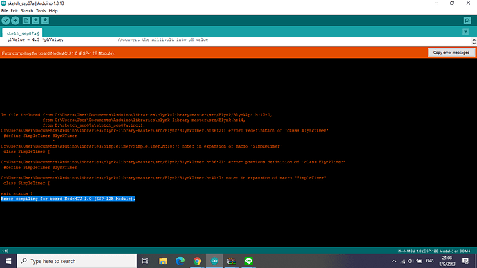

now that problem is clear but it error here. error compiling for board nodemcu 1.0 (esp-12e module)

Change this line:
to this:
and delete the following lines…

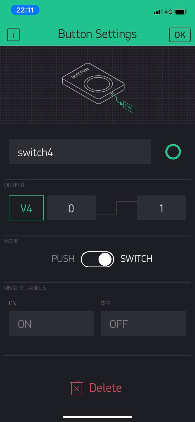

when I push botton , Relay doesn’t work acutually it must to play relay 1 , 3 and 4 but It don’t have anything happen. (same code , How I can fix it?? )
Thank you for your helping.
What exactly does this mean?
Did you sort-out your void loop ?
How are you powering your relays, and can you make them work by connecting the In1, 2, 3 & 4 pins to GND or VCC?
