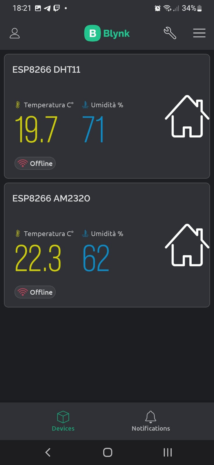

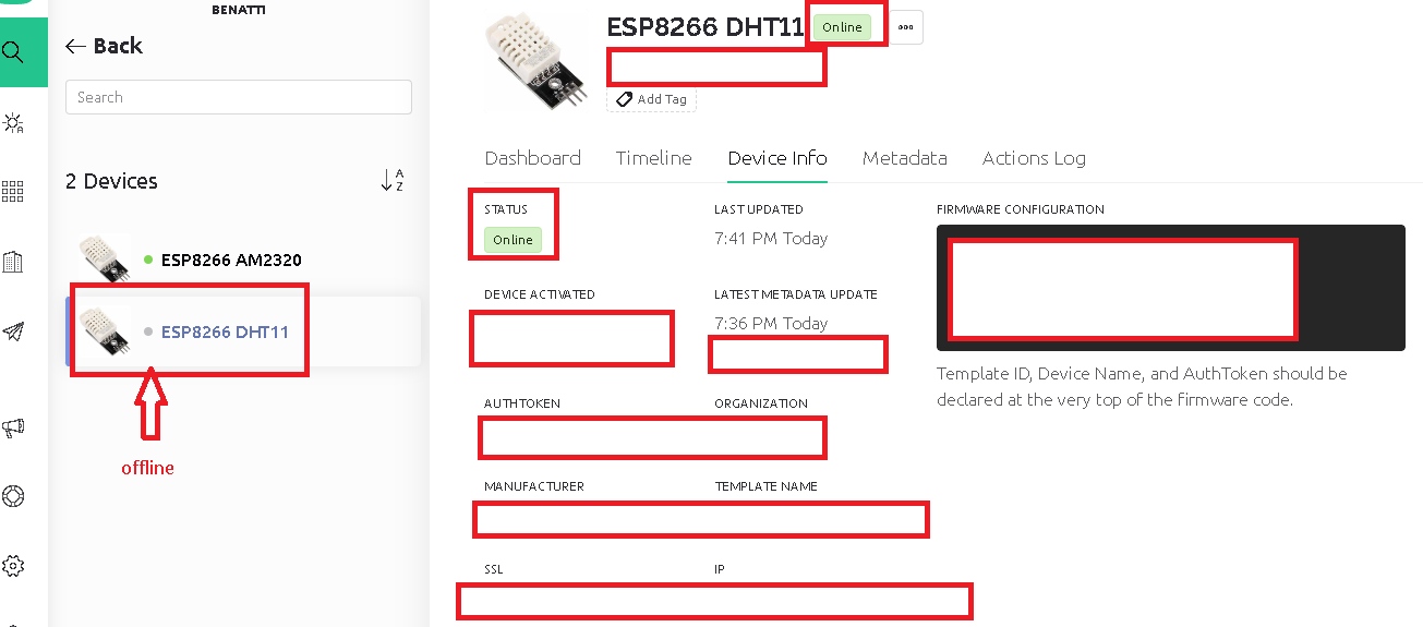

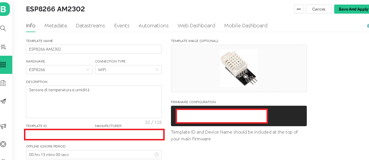

Everything works correctly, however, I was asking if it was possible to notify the “Offline” status on the app only after 10-15 minutes ESP8266 is offline since last values updates.
