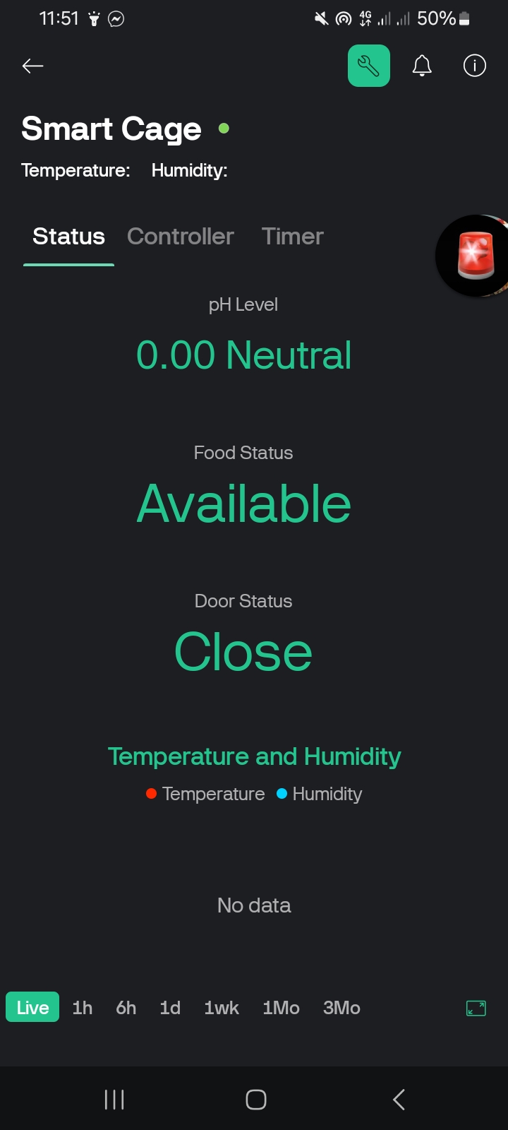

Hello could you help me show the issue in this project the blynk does not show the values in my blynk app. Please help me thank you
Source code:

// Send pH value and status to Blynk
Blynk.virtualWrite(V4, phValueAndStatus);

double humidity = dht.readHumidity();
double temp = dht.readTemperature();
// Send temperature and humidity data to Blynk
Blynk.virtualWrite(V15, temp);
Blynk.virtualWrite(V16, humidity);
checkTime();
checkFoodStatus();
readTouchSensor();
fanControl(temp);
