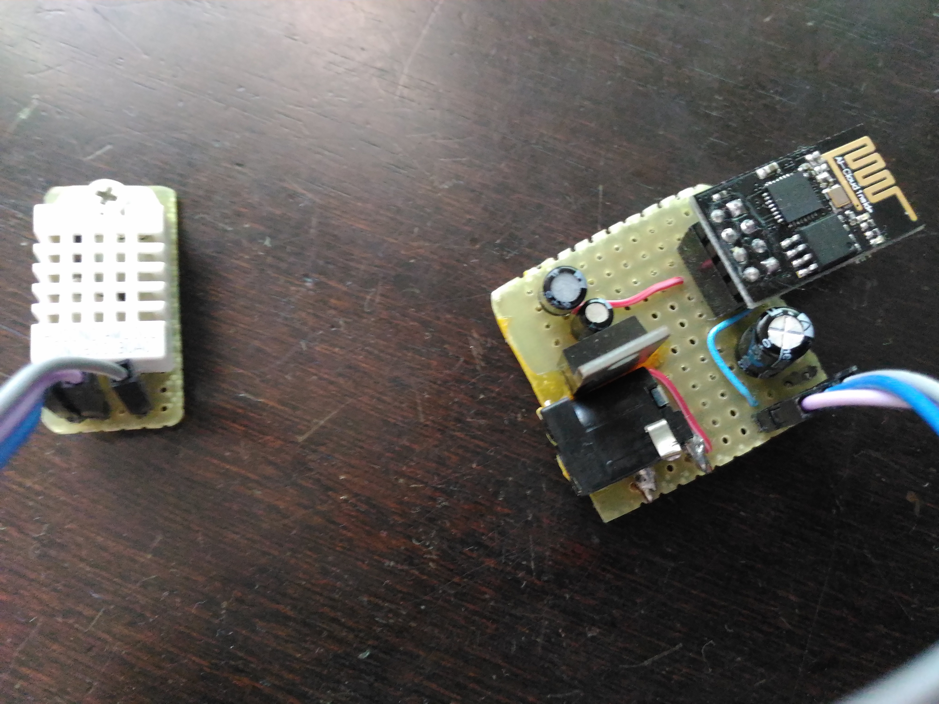

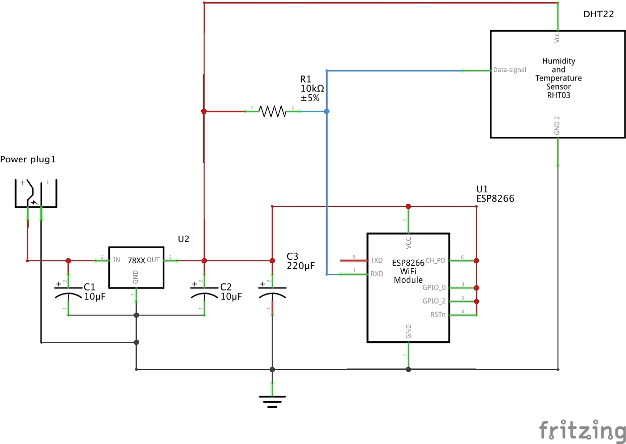

@psoro @kranick @Dave1829 After a few tries i decided to make an esp01 board with a connector for the dht22 and it works flawless. this is how it looks.
I hope it could be helpful.
