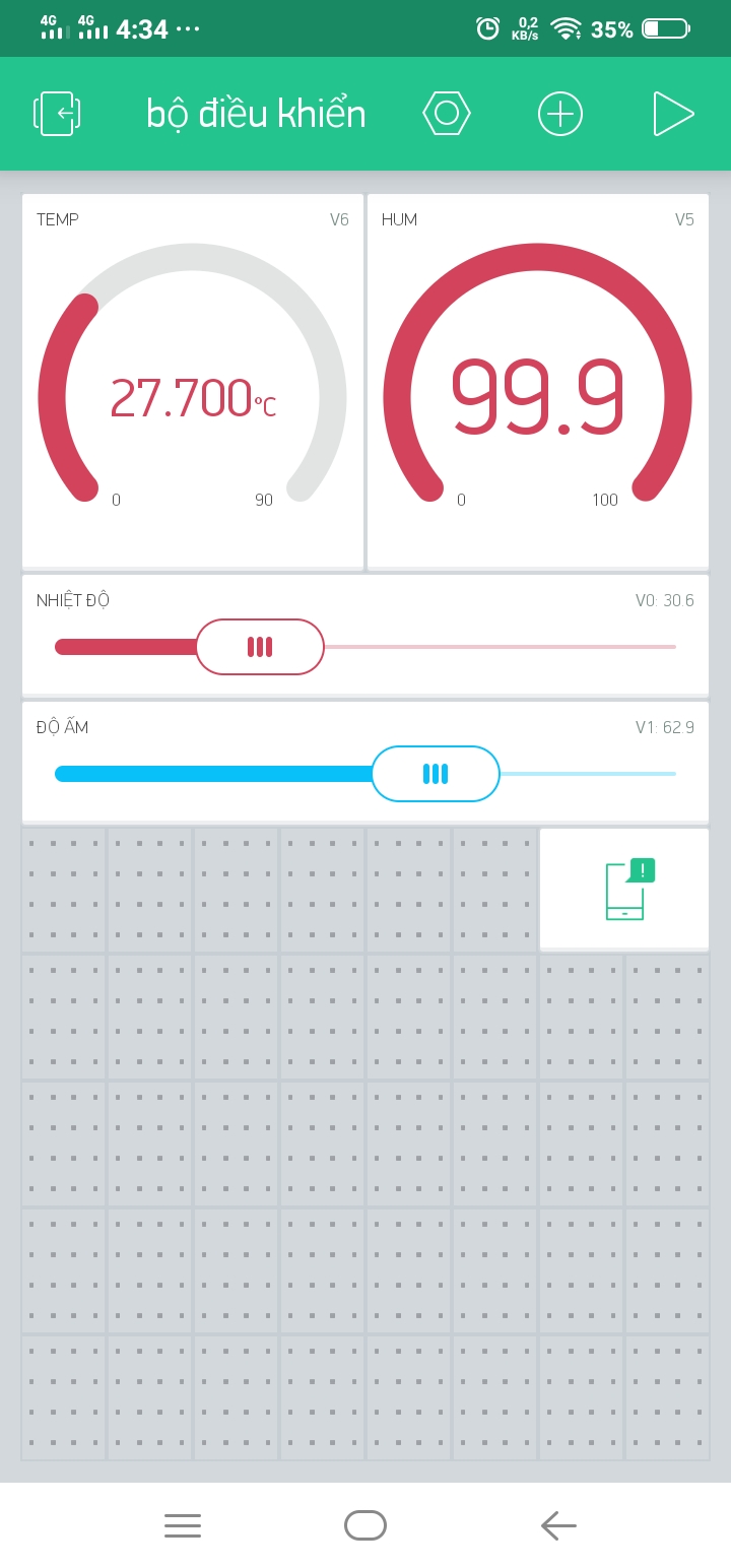

Hi everyone, my project is to monitor and control the temperature and humidity using esp8266, but here the temperature was correct but in contrast the humidity was wrong, it was only 99.9. Can anyone help me know the cause?
Not without seeing your code.
