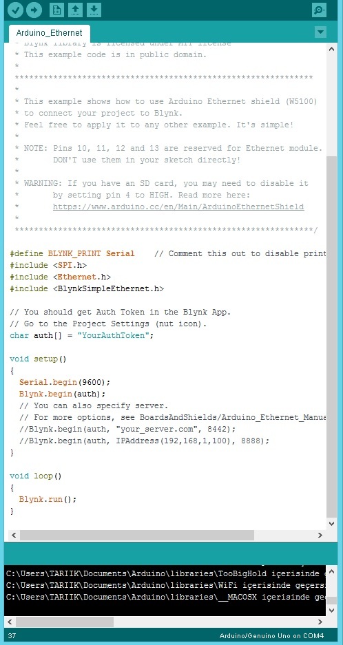

hello friends I have a problem related to the ethernet shield
I use library blynk v0.3.8
constantly waiting for that
[0] Blynk v0.3.8 on Arduino Uno
[0] Getting IP…
[60460] DHCP Failed!
[0] Getting IP…

i use 1,6,11and open examples arduino ethernet shield
[0] Blynk v0.3.9 on Arduino Uno
[0] Getting IP…
[60447] DHCP Failed!
[1] Getting IP…
[60448] DHCP Failed!
[0] Getting IP…
idont understand why have this …
Ethernet is a different story, need to check this.
Meanwhile, can you post your full sketch code?
i m write auth code normalyy . this skecth in delete
Please check latest example, it should include more code (disabling SD card): https://github.com/blynkkk/blynk-library/blob/master/examples/Boards_Ethernet/Arduino_Ethernet/Arduino_Ethernet.ino
i no have sd card slot in and i try this example still
