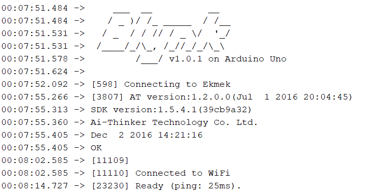

Device is Offline even serial port screen says Ready (ping: 23ms) urgent!
Device is Arduino Uno with ESP 01 WiFi module.
But still says offline in the console…

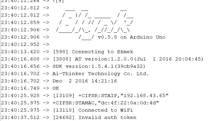

You are trying to connect to legacy Blynk server
Use that
Did you mean “Blynk.begin(auth, wifi, ssid, pass);” I am getting Invalid auth token error with that(I am pretty sure it’s not wrong).
You need to tell us whether you are using Blynk Legacy or Blynk IoT

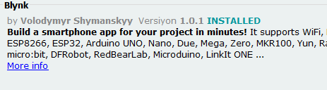

Either way, you are using the wrong Blynk library. If you are using Legacy then you should be using 0.6.1
If you are using Blynk IoT then it should be 1.0.1
I tried to use IoT image
it says 1.0.1 is there any way to update properly?

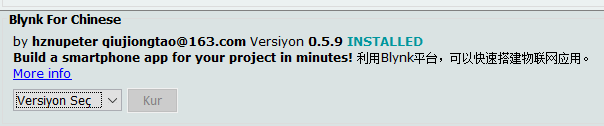

I guess I accidently installed Chinese one too so this can be problem I am gonna try to remove this.

And it is online
I deleted Chinese version from My Documents/Arduino/libraries now it’s working thank you <3
Edit: It comes online for a sec when restart and then wents offline again… i don’t know why.

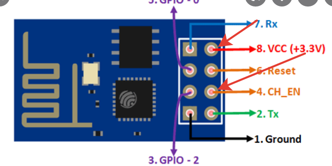

How are you powering your ESP-01 ?
3.3V to VCC and CH_EN pins image
From Arduino uno to Bread Board
Assembling the components on a breadboard isn’t a great idea, they are notorious for poor quality connections.
Also, it’s a good idea to power the ESP-01 with a separate psu, with shared ground.
But, if you really want a reliable result then throw this hardware away and use a NodeMCU or ESP32 dev board.
