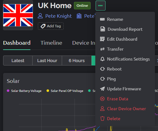

In the web console select the device and click on the three dots next to the On/Offline status…
Choose “Erase Data” then you’ll see this menu…
Selecting “Historical Data” will clear the datastream history that you see in the SuperChart.
