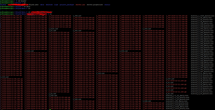

These are the logs I’m talking about:

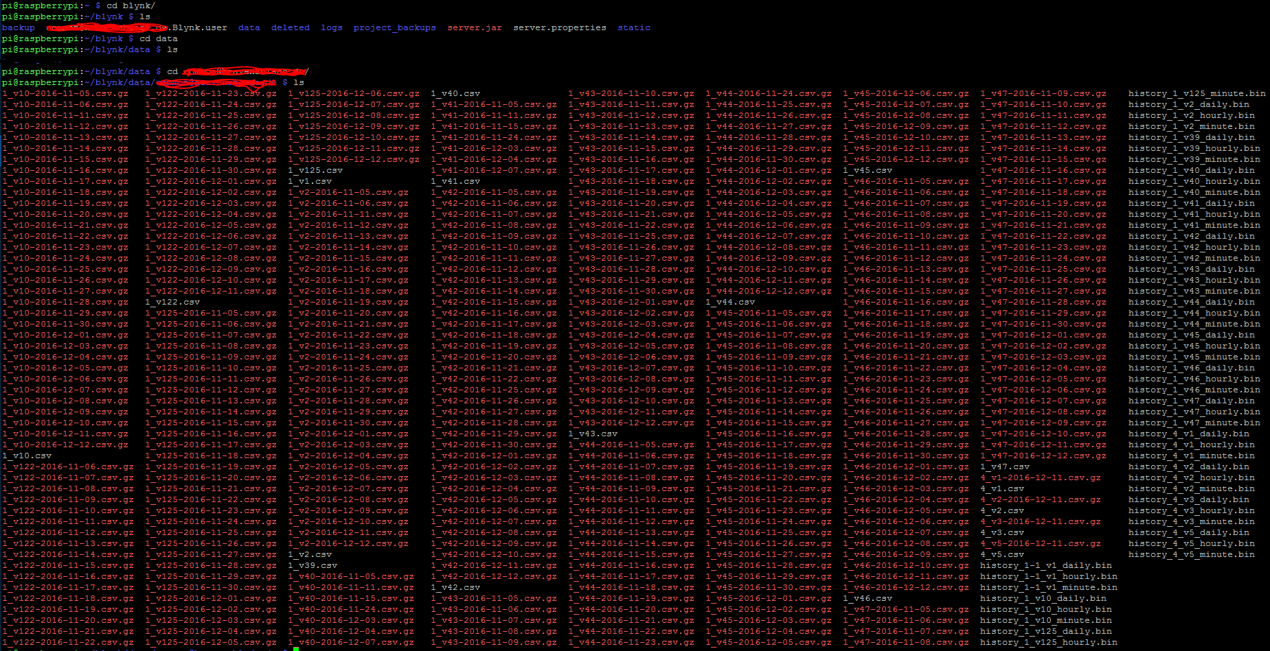

hmm, here are the newly created files now in the /blynk/data folder.
It looks to me that the naming is buggy though:
