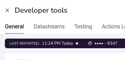

This is bizarre, I got the device token from the developer settings on the device and I even tried the region specific URLs, like “ny3.blynk.cloud” and so on, none of them worked. All the same error.

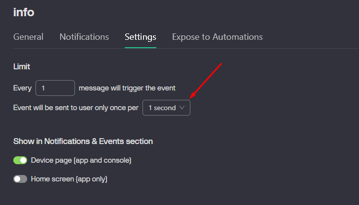

I got it to work now. By the way, why cant i trigger two of the same push notifications sequentially. I see the first one, but when I trigger the same push notification curl command a few minutes later it does not show on my device.
Is that by design? How can I change that aspect.

This may be related to the time set in the event settings. Please check this limit in event settings:
