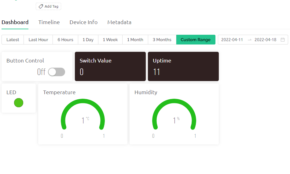

Okay, so, I changed some things around with the DHT calls and I think I’m making progress. Sorry, I did listen, I just forgot to change it after I pasted it into the IDE. Here’s my code as of now and a screenshot of the Blynk dashboard. Before I wasn’t getting anything on the gauges. Now, I’m at least getting something. It’s maxing out at 1 degree and 1% for some reason. Any ideas?
