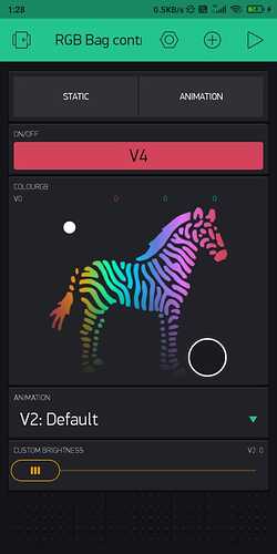

given below is the design of my app
i will now explain features what i am trying to add
when switch is OFF then nothing should work
but when i turn on switch depending on the mode which i have selected
if its static then based on the current rgb value in zeRGBa led’s should turn on
and if its in animated mode then default animation should start
if i have selected animation then nothing related to static to should work
if i have selected static then nothing related to animation should work
and every led should turn on depending on the current brightness
and as i change brightness in app brightness of led should change too
for example in static mode when i change brightness i can see change applied and don’t need to select color again but when i change brightness in animation mode i need to restart animation to see the change applied.
