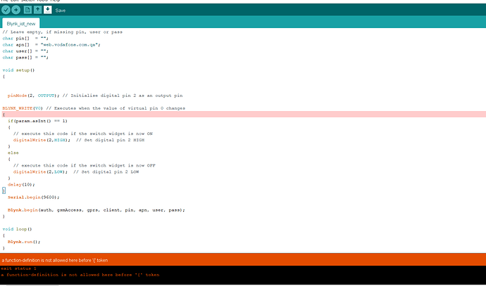

hello guys, i wanna control a LED using MRK 1400 GSM and blynk app and i tried to use the right program for that but im getting error and i have no idea whats is the best syntaxe for that.

  pinMode(2, OUTPUT); // Initialise digital pin 2 as an output pin
BLYNK_WRITE(V0) // Executes when the value of virtual pin 0 changes
  if(param.asInt() == 1)
    // execute this code if the switch widget is now ON
    digitalWrite(2,HIGH);  // Set digital pin 2 HIGH
    // execute this code if the switch widget is now OFF
    digitalWrite(2,LOW);  // Set digital pin 2 LOW
  Blynk.begin(auth, gsmAccess, gprs, client, pin, apn, user, pass);
Don’t you think that sharing some details of the error message would be sensible?
You can’t put a function inside a function in C++
The BLYNK_WRIRE(V0) function cannot be inside the void setup() function.
