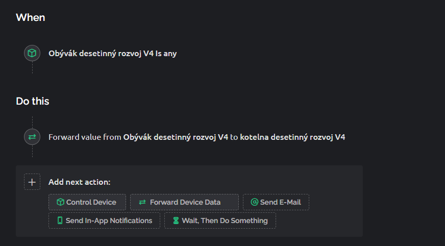

Good day,
two years ago I started a project to regulate the heating of an electric boiler. In the project I use two arduino mega boards. One board is only to measure the value from dht 22 in one room and send it to the other device. The second device controls the relay and measures a few other values (dht 22 sensors and max 6675 thermometer). The current problem is that the arduino mega with the relay starts disconnecting from the server after about a day after startup. It always disconnects for a few seconds and then reconnects, board can’t be controlled in this time. When I tried the output in the serial monitor, the arduino writes the message “heartbeat timeout”. Thanks for help. I am attaching the code (board with relay):
