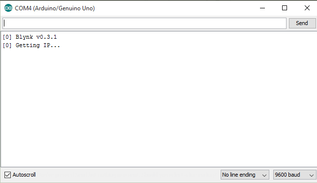

guys i am working on a project to fetch data from sensor and send it to the blynk server using esp8266 esp-01 module and i am facing a lot of problem in connection…need u ppl to help…plz tell me step-by-step connection

yes…i already reffered that link given by you…the problem i’m facing that it is not getting connected and not reading the ip address of system

Firstly, have you setup a basic USB connection as a test? It will help you understand how blynk works: https://codebender.cc/example/BlynkSimpleEthernet/BoardsAndShields:Arduino_Serial_USB#Arduino_Serial_USB.ino

Then this detailed tutorial on esp8266+arduino may help: https://www.hackster.io/nolan-mathews/connect-to-blynk-using-esp8266-as-arduino-uno-wifi-shield-m1-46a453
thanks srijal it’s working bro
