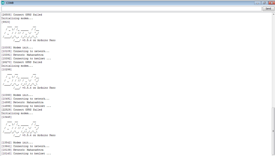

Hi, I am trying to connect Blynk using SIM800A GSM module and Arduino Nano.
When I connect it to my Arduino nano the module is connecting to the network but failing to connect GPRS(Attach).

I will check with 9600 baud rate but it is finding network also connecting to network with baud rate of 38400.
The problem is in attaching the GPRS only.

Have you tried turning on all your debugging?
Please post your serial debugging (set up in IDE)
