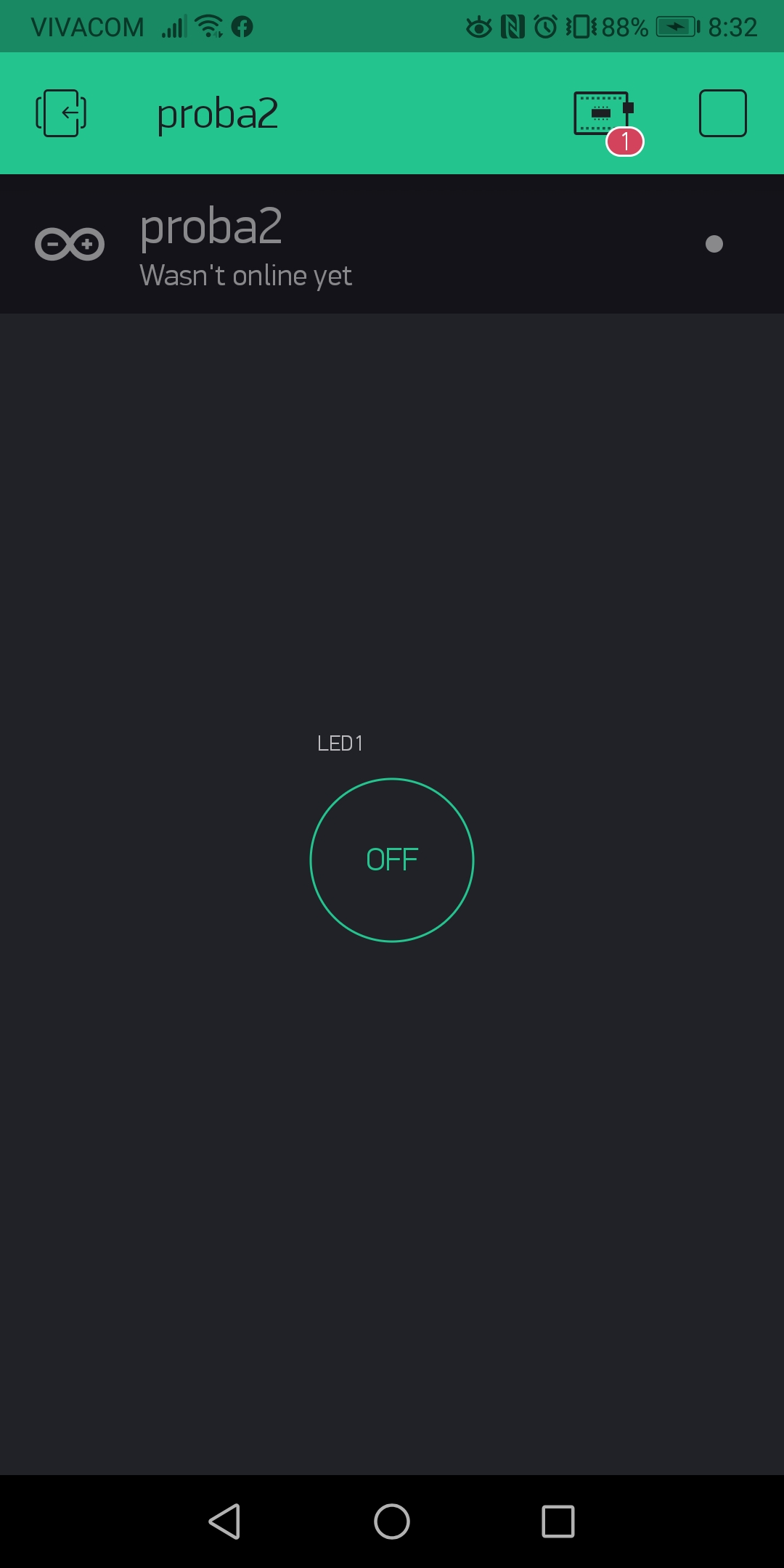

I work with arduino MKR 1010. I would like to use Blynk app for WiFi control. I installed Blynk app and start programming one of the digital pins as an output. I make my programs on my smart phone but I have the following error: wasn’t online yet
when I try to connect the board. During the configuration procedure I didn’t find Arduino MKR 1010 and I selected Arduino MKR 1000. Is it a problem?
I realized that when I uploaded the program on my arduino board it started to connect and disconnect repeatedly. I use Linux OS and online editor for arduino programming. Is it necessary to install the offline editor or the online tool is stable enough? I uploaded one simple program without using Blynk app and my board is stable connected now. I am afraid that when I start using Blynk app again the connect and disconnect problem will appear again. Could you please help?

Here is my code (this code is from my computer and the screenshot image is from my smart phone):

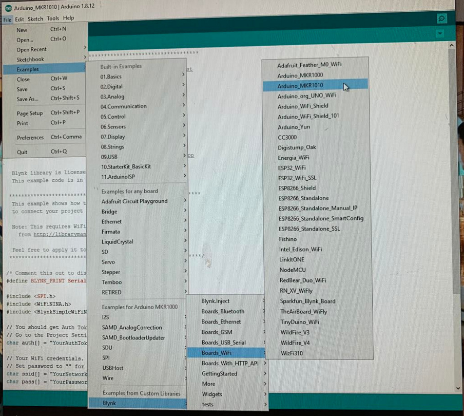

In the Arduino IDE open: File | Examples | Blynk | Boards_Wifi | Arduino_MKR1010
You’ll notice this sketch uses a different Blynk library than the one you are using, also keep your Blynk.begin() statement simple, don’t use custom server or IP:Port unless you really have to:
Try this and see how you go
