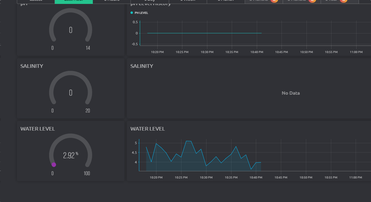

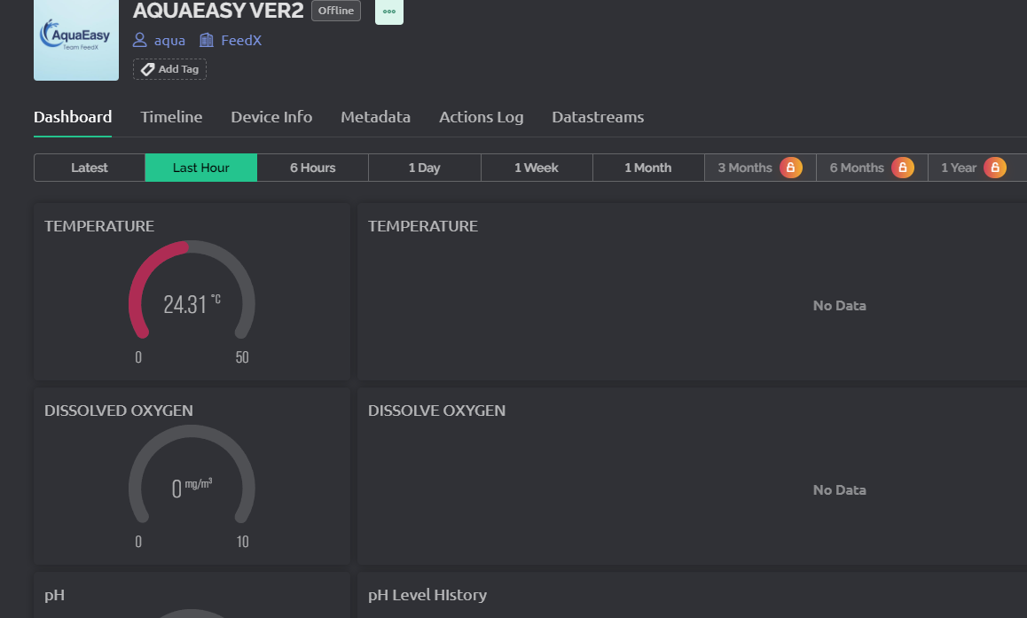

yes, they matched. I used ‘for any’ instead of ‘has changed’ . they synchvery well in live readings. switches are too, they can be used in one dashboard even when they are in a separate device.
The only problem was as I talked about earlier, it does not seem to save data history to each other. I checked the enabled data history thoroughly btw

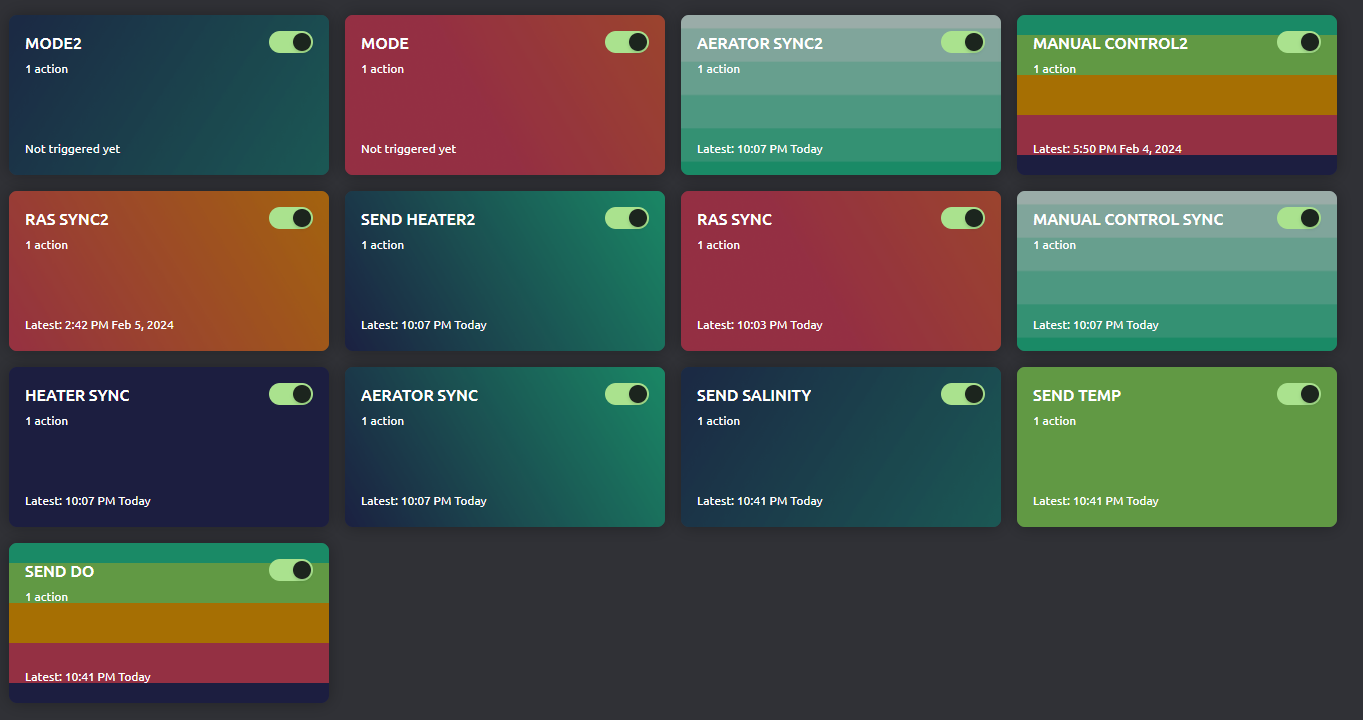

I’ve used multiple automations for sensor values. Liked basically I have forwarded data to each of them to synch the values.

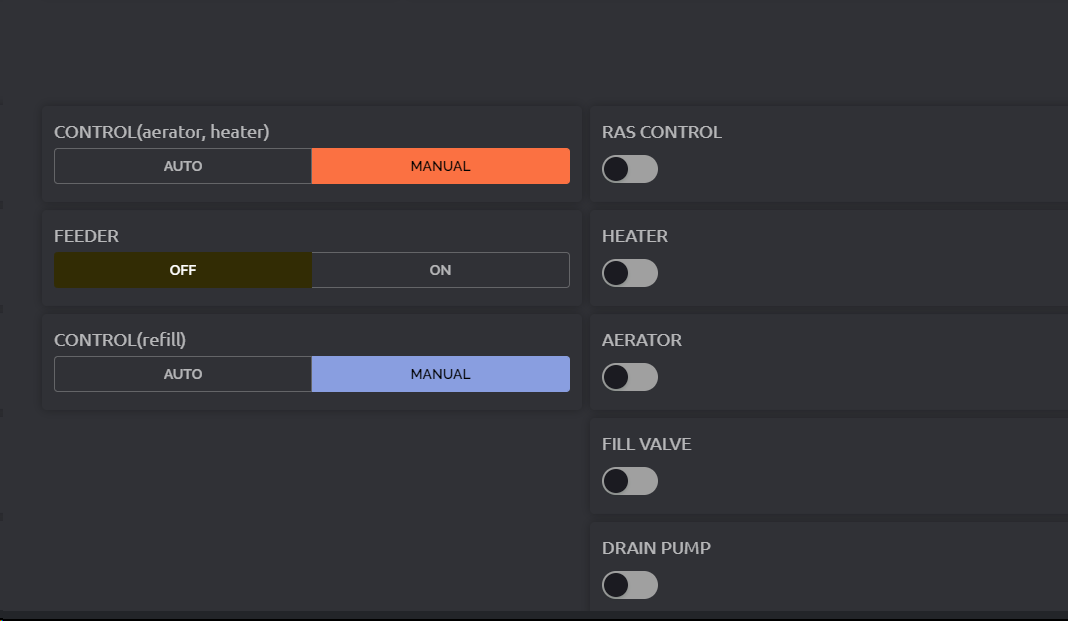

this is my dashboard, both of devices’ dashboard are basically the same
Are you sure about this?

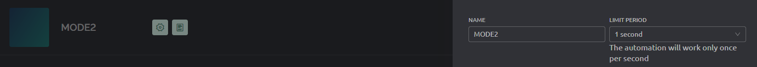

I’ve just done a very quick test with a rapidly changing datastream and the automation only updates the target device once every minute.
You can change the limit for it to update per 1 second. That’s more than enough.

So here’s an update. I tried to send multiple data streams using the example you have given me and it actually fixed the problem I have been dealing with which is saving and displaying data history on a chart.
The issue is that calling the API multiple times in quick succession to send multiple datastreams, then repeating this again a few seconds later isn’t the best practice and could also result in you hitting the maximum number of API calls in a 24 hour period.
Blynk has an API to send multiple datastreams in a single API call, and I linked you to that in an earlier post.
You should look at using this API instead, by modifying the code to allow multiple pins and multiple pin values to be passed to the api_bridge function, and modifying the server_pathto include the batch keyword.
