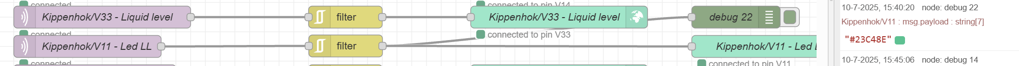

Fragment of the Nodered plan:

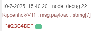

Result of debug node with incoming message:

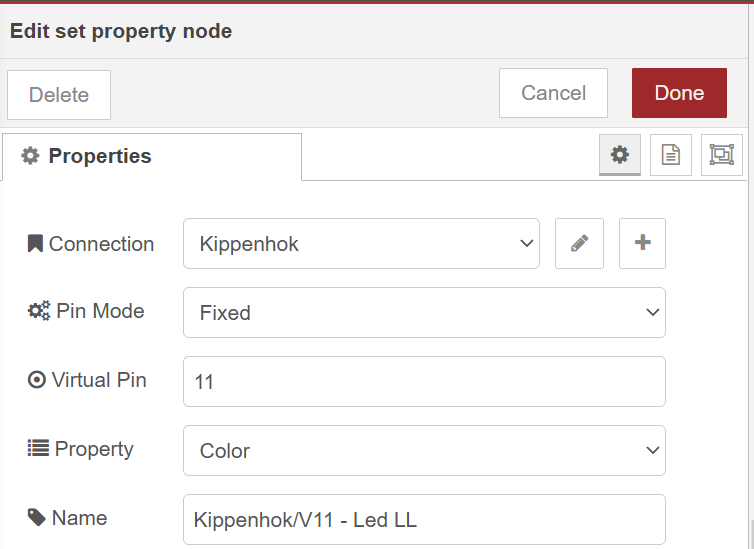

set-property node:
