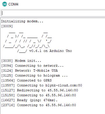

I’m trying to setup my GSM800 with blynk and arduino uno. I am able to connect to blynk briefly- the app on my phone even acknowledges that the device is connected. The problem is that after a few seconds the device goes offline and my serial monitor says Connecting to 45.55.96.146:80
21:56:24.936 -> Initializing modem…
21:56:34.488 -> [12591]
21:56:34.525 -> ___ __ __
21:56:34.561 -> / _ )/ /_ _____ / /__
21:56:34.561 -> / _ / / // / _ / '/
21:56:34.597 -> ///_, /////_
21:56:34.633 -> /__/ v0.6.1 on Arduino Uno
21:56:34.669 ->
21:56:34.669 -> [12684] Modem init…
21:56:34.921 -> [12997] Connecting to network…
21:56:48.836 -> [26927] Network: T-Mobile USA
21:56:48.872 -> [26928] Connecting to hologram …
21:57:06.391 -> [44434] Connected to GPRS
21:57:06.427 -> [44503] Connecting to blynk-cloud.com:80
21:57:10.104 -> [48164] Redirecting to 45.55.96.146:80
21:57:10.176 -> [48246] Connecting to 45.55.96.146:80
21:57:12.736 -> [50795] Ready (ping: 1364ms).
21:58:23.920 -> [121908] Connecting to 45.55.96.146:80
21:59:42.067 -> [199998] Connecting to 45.55.96.146:80
22:01:00.198 -> [278088] Connecting to 45.55.96.146:80
22:02:18.370 -> [356178] Connecting to 45.55.96.146:80
22:03:36.520 -> [434269] Connecting to 45.55.96.146:80
22:04:54.672 -> [512358] Connecting to 45.55.96.146:80
For right now I am just trying to use the basic blynk blink sketch. Have tried several baud rates, no luck. Any ideas?

I don’t have the same setup / hardware, but just have some hypothesis as follows:
Your code seems OK, so the issue might be:
Your Network: T-Mobile USA or your SIM card (unlocked??). Did you try with another Mobile provider or SIM card?
Your SoftwareSerial speed set at low speed of 9600. Try to change to other speed such as 38400
When using SoftwareSerial (on Uno, Nano, etc), the speed 115200 may not work. Try selecting 57600 , 38400 , or even lower - the one that works best for you. In some cases 9600 is unstable, but using 38400 helps, etc. Be sure to set correct TX/RX pins in the sketch. Please note that not every Arduino pin can serve as TX or RX pin. Read more about SoftSerial options and configuration here and here.`
Try the better AltSoftSerial instead of SoftwareSerial
Use only HardwareSerial at 115200 (modem connected to pin 0 (RX) and pin 1 (TX)).
In this case, you can’t use USB / Serial to debug.
Before connecting UNO to USB to upload firmware, remove modem.
After upload firmware to UNO, you have to remove UNO out of USB port, connect modem then test using external power supply.
You have to look at the Blynk APP to see if the modem is connected or not.

Blynk has three cloud servers around the globe - in New York, Frankfurt and Singapore - and your project exists on only one of them.
When you try to connect to your project via blynk-cloud.com the ISP’s DNS servers will normally want to take you to the geographically nearest server, but Blynk then does some clever stuff to take you to the correct server where your project lives. When this happens, you get the “Redirecting to …” message that you’re seeing in your screenshot.
The interesting thing is that 45.55.96.146 is the IP address for Blynk’s New York Server, so for some reason your mobile ISP is initially trying to connect to a different server and is being redirected.
Your Ping time is quite high at 676ms in this particular screenshot, and double that in your first post; and I guess that some of this may be due to the redirection process.
I think I’d try specifying 45.55.96.146 as the server in your Blynk.begin command and see if that helps. You might also want to specify the port of 8080 in case your mobile ISP is blocking port 80.
The strange characters are because the MCU is resetting. If you change your serial baud rate until these messages make sense, then use that as the serial baud rate in the sketch, you’ll be able to see both sets of messages in the serial monitor.
What happens if you put the IP address in this format “45.55.96.146” rather than specifying it as an IPAddress variable type?
