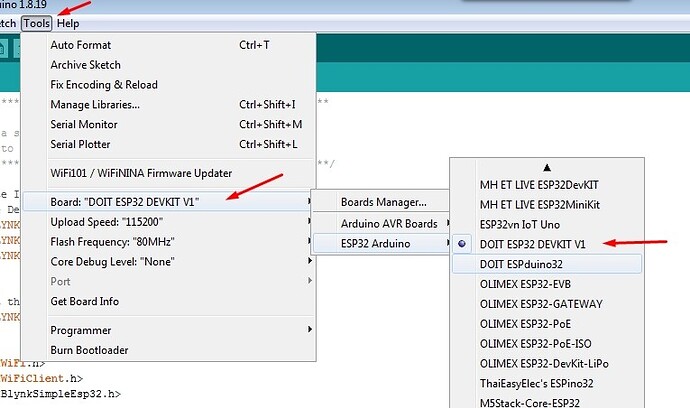

Did you choose Esp32 Devkit V1 in Boards?
Yes.
In older boards same code is working fine.
Very strange.
Select ESP32 DEV MODULE from the list under boards. This should solve the issue.
Did not worked, @Madhukesh.
