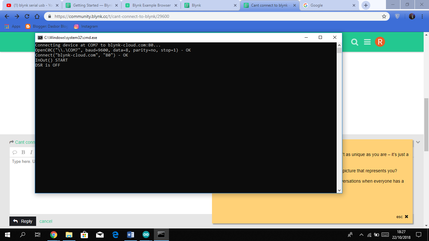

Cant connect to blynk
Please help, i just copy paste from blynk example, and paste the auth token, and run the script, says it works fine, but in the app says my arduino mega havent online :frowning:

Is COM7 the correct port for your MCU device?
Are you running an Arduino MEGA or something else with this 2nd hardware Serial1 port? If so, do you have a TTL-USB adapter that you can plug in and run a 2nd terminal program like termite so you can see the debug info?
