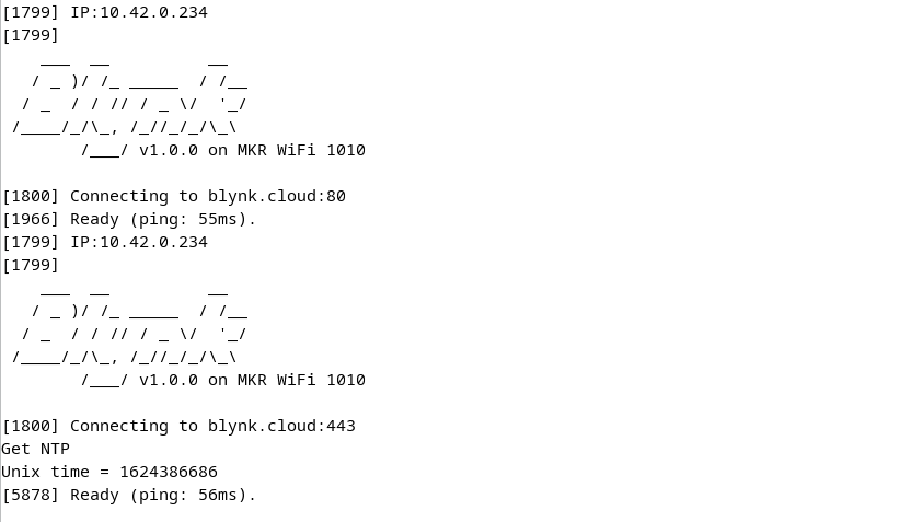

I don’t have any Ethernet2 shields atm, so I tried Arduino MKR 1010 with MKR ETH chip.
This setup uses ordinary Ethernet library.
Just added my BLYNK_TEMPLATE_ID and auth token, and I was able to connect. Both TCP and SSL worked:
You should first check if ordinary Ethernet2 library examples work with your configuration.
