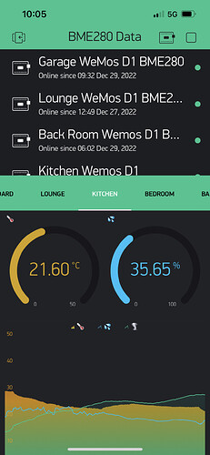

In Blynk1.0 I have a Project (BME280 Data) - there are six devices connected to this project sending THP from BME280 sensors. I use tabs to create separate ‘pages’ for each sensor, and the first tab (page) as a dashboard showing the temperature from each sensor. I can select the relevant tab to get the full data/control for each device.

Had a look at it . . . it appears that you can only customise the tiles associated with each individual device - you can select multiple display types and datastreams - but only from that device - not from multiple devices.
Close to the old project/tabs - but limited in that devices are sorted in alpha/numeric order in the mobile dashboard. There’s no way to group devices created from the same template together, and the tile display options are far more limited than legacy widgets as far as size, colour, labels, formatting etc. Also you can’t scale the tiles to fit more devices on the mobile dashboard.

That’s correct.
If you want to do this…
Then you have to send data from one or more ‘slave’ devices to a ‘master’ device and use that to display your data.
