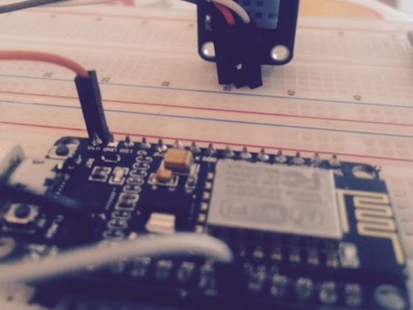

Maybe this will help get you started …
//This sketch is combined from Adafruit DHT sensor and tdicola
//for dht.h library
//Along with some esp8266 NodeMCU specifics from teos009
// https://learn.adafruit.com/dht/overview
// https://gist.github.com/teos0009/acad7d1e54b97f4b2a88
//other Authors Arduino and associated Google Script:
//Aditya Riska Putra
//Ahmed Reza Rafsanzani
//Ryan Eko Saputro
//See Also
//http://jarkomdityaz.appspot.com/
//ELINS UGM
//Modified for Hackster.io project to the ESP8266 from
//a Ethernet Sheild project
//by Stephen Borsay
//Since Arduino can't handle https, we need to use Pushingbox API
//(uses http)to run
//the Google Script (uses https).
#include "ESP8266WiFi.h"
#include "DHT.h"
#define DHTPIN 2 // what digital pin we're connected to
//pin2 to D4 on esp board
// Uncomment whatever DHT sensor type you're using!
#define DHTTYPE DHT11 // DHT 11
//#define DHTTYPE DHT21 // DHT 21
//#define DHTTYPE DHT22 // DHT 22
DHT dht(DHTPIN,DHTTYPE);
