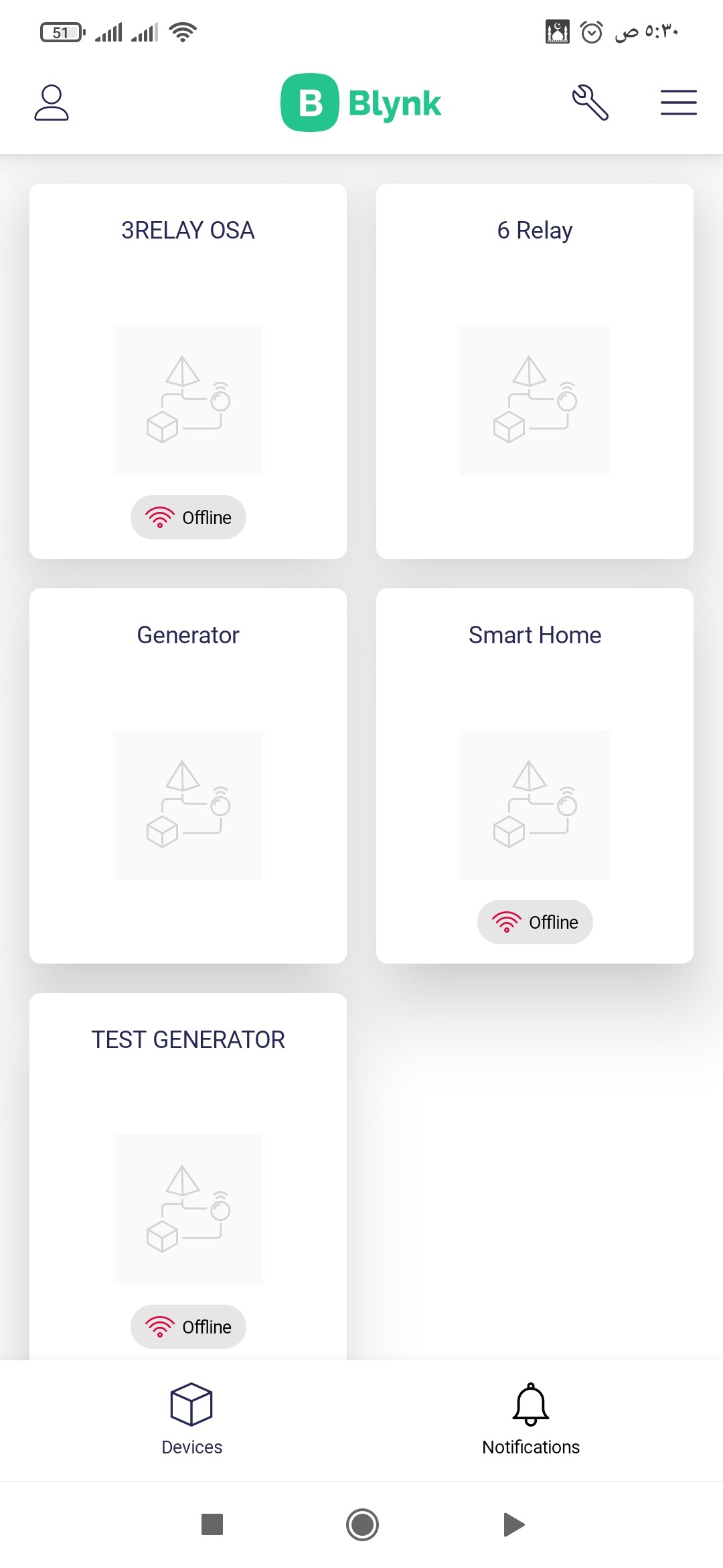

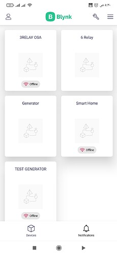

Please reduce the size of the device icons because they occupy a large area of ​​the main interface and add the option to arrange devices as desired
