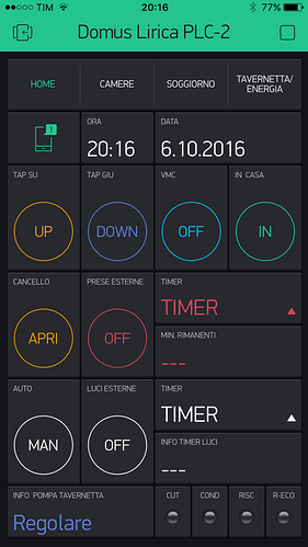

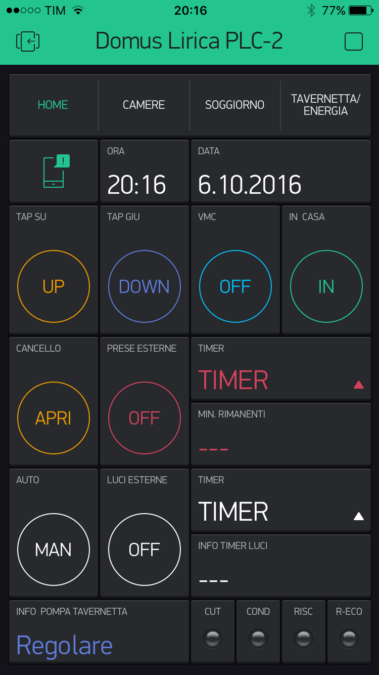

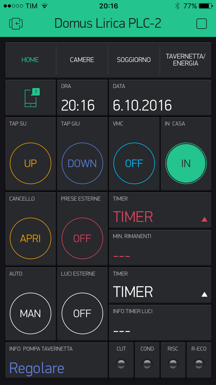

The button sometimes goes into a freeze state (pushing the button, it flashes but does not change the state) or change the state but not the color. In case of switch mode it’s not a big deal, but for my shades, the wrong state visualisation is a big problem.
In the pictures you can see the the button “In Casa” with color changes for same states. It also happens no color change for different states.
