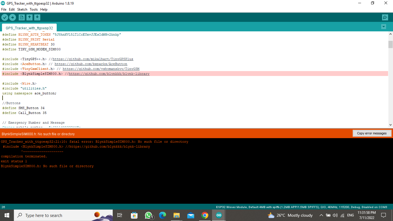

BlynkSimpleSIM800.h: No such file or directory
BlynkSimpleSIM800.h: No such file or directory how to solve it a problem? Does any solution to solve it?

i try it already but still cannot be sucess find a library file

I’ve already pointed you to a topic which explains that you are using an outdated method, but instead of switching to the #include <BlynkSimpleTinyGSM.h> approach you are persisting with the outdated and now unsupported #include <BlynkSimpleGSM800.h> approach.
