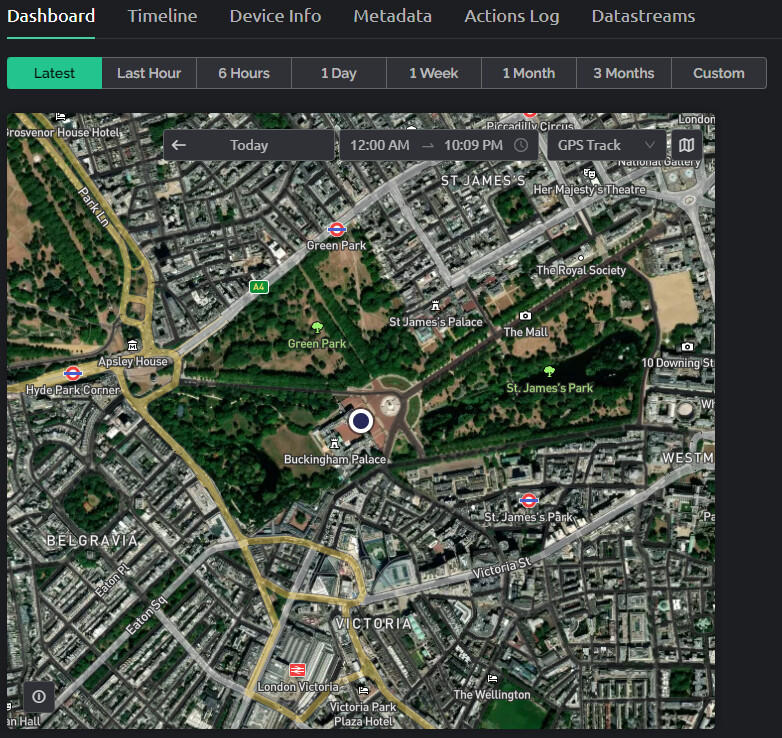

I set-up a Location datatsream attached to pin V3, and added a Map widget to the web dashboard attached to V3.
I looked-up the Lon/Lat for Buckingham Palace and settled on -0.1418542,51.5014389
I didn’t bother looking at the documentation, and added an HTTP Request node in Node-Red, with an inject node to trigger it and a Debug node (set to Complete Message Object) to view the response…
The HTTP request URL was:
https://lon1.blynk.cloud/external/api/update?token=REDACTED&v3=-0.1418542,51.5014389
You’ll need to change the blynk.cloud sub domain to suit your location, and replace “REDACTED” with your auth token.
Triggering the Inject node and refreshing the web browser (set to “Latest”) produced this,

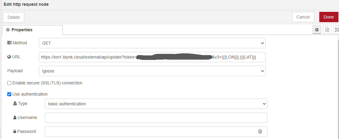

Going back to the process of pushing Lon/Lat values to Blynk using the HTTP Request node, you can pass the Lat and Lon values in as elements of the message and use JSON moustache bracket thingies to to embed these into the HTTP request URL…
This is the yellow Change node that I’bve used to set the values…
and this is the HTTP Request node…
The URL now looks like this:
https://lon1.blynk.cloud/external/api/update?token=REDACTED&v3={{{LON}}},{{{LAT}}}
