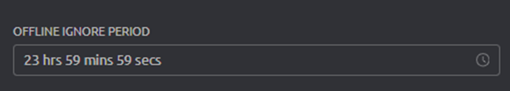

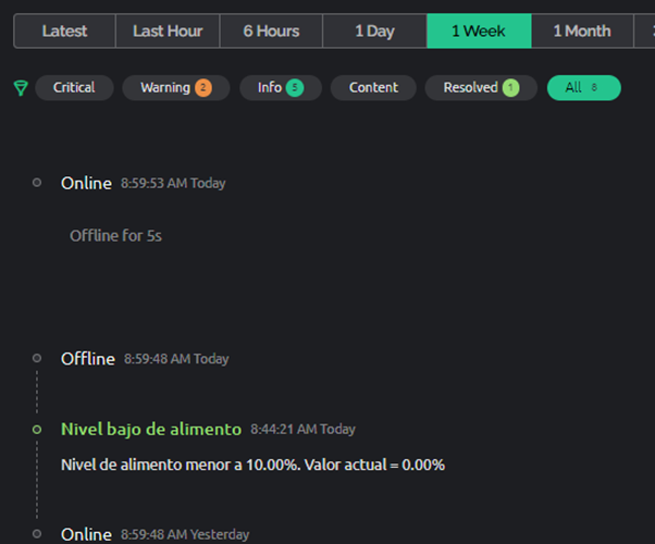

Hello. I want to check because I have repeated (every day) notifications from offline devices that are not correct.
The devices connect only once every 24 hours, always at the same time. The connection takes approximately 6 seconds in total. I observe the following sequence in the events and notifications in the app:

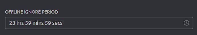

@Terabot Is not reproduced for me. Have you tried using BLYNK_HEARTBEAT interval instead of ignore period?
hello! I am going to modify the “BLYNK_HEARTBEAT” parameter to 86400. Anyway, is it possible to increase it to 48 hours to report an offline device?

@Pavlo Its Possible to extend the offline period to 48hs on the template general setting?
