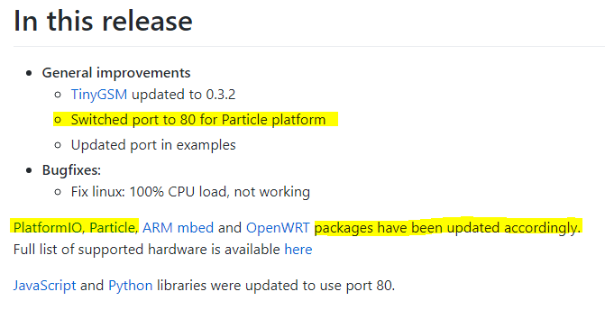

I believe even Cloud Server requires it now… but that should be Automatic, so try upgrading the Library to the latest (v0.5.2) and reflashing your devices… v0.5.1 is sooo February '18 :stuck_out_tongue:
As shown in the release updates for v0.5.2…

@Gunner quick update. I did check in the particle IDE and the latest version of the Blynk library 0.5.1 does use port 80 as you suggested.

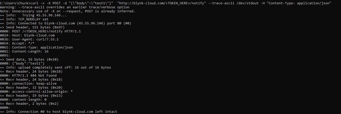

Go to Terminal (or other console application), and execute following command:
curl -v -X POST -d "{\"body\":\"test1\"}"  "http://blynk-cloud.com/<TOKEN_HERE>/notify" --trace-ascii /dev/stdout -H "Content-Type: application/json"
Check response for error description.
Here are the results
Replace <TOKEN_HERE> with actual your token
One more try: remove “<” and “>” around your token.

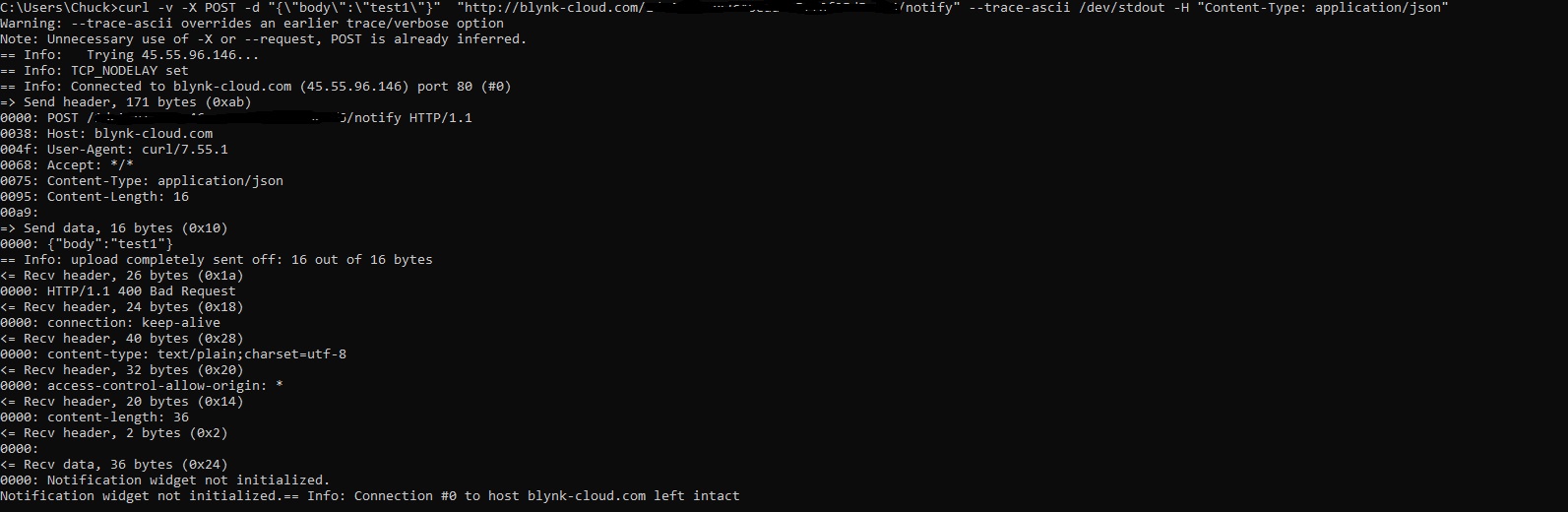

HTTP api is described here: https://blynkapi.docs.apiary.io/#reference/0/send-push-notification/notify
Thanks for the link, apologies for the errors
So the error is “Notification widget is not initialized” which means either there is no Notifications widget in the project or that your system prohibited push notifications for Blynk.
Double check that you have Allow Notifications set in System Settings-> Blynk -> Notifications
