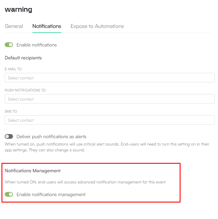

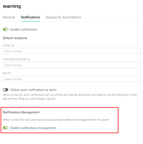

You need to enable the “Notifications Management” option in the event settings.

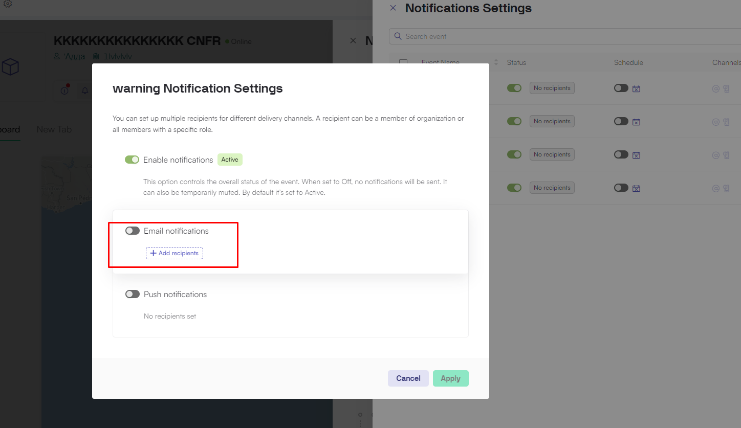

Then, in the menu: Dashboard - Notifications & Events - Notification Settings, you can select any user in the organization.
