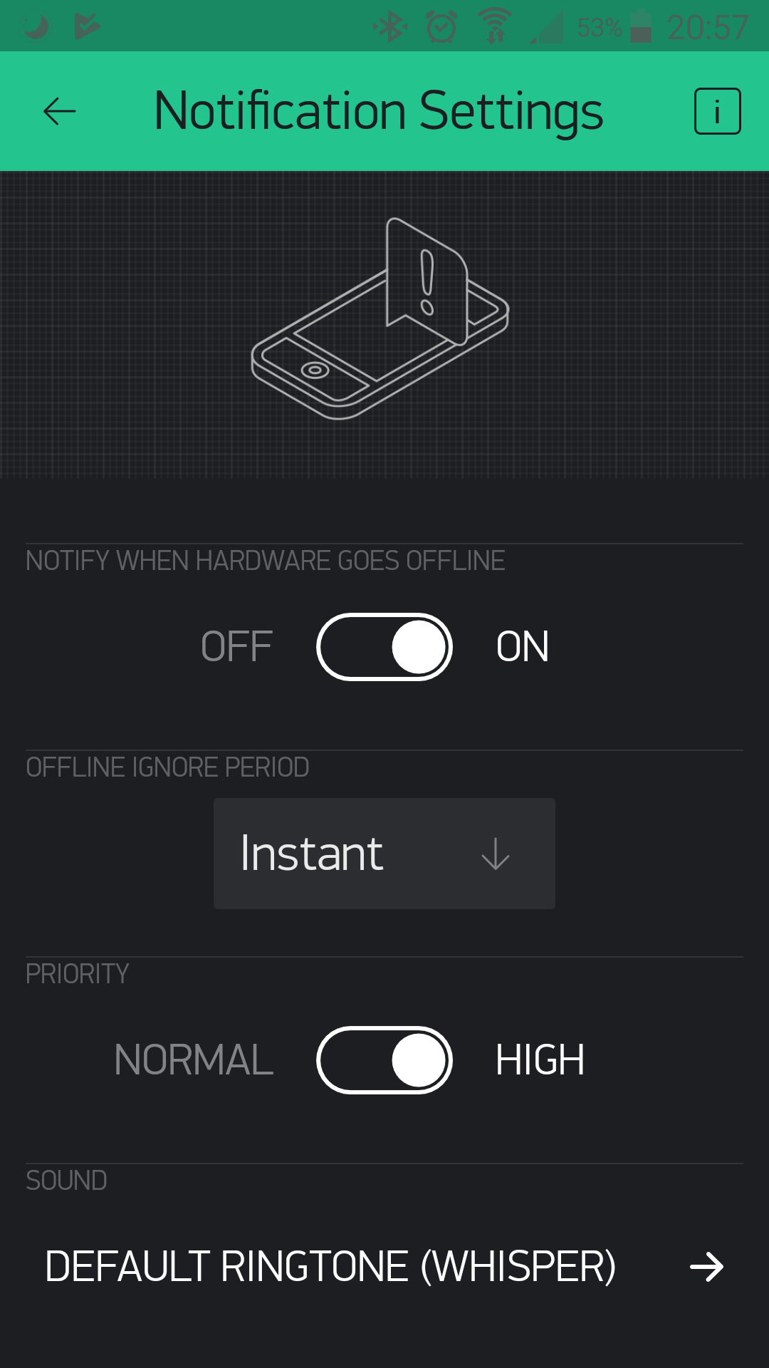

there is a new app update, which contains a different logic implemented regarding notifications, also some bug fixes. please try it and see if it helps.
also, did you enabled notifications when hw goes offline, in notification widget?

the offline notification works from the app notification widget. practically, the server waits 15 seconds to see if the tcp connection is alive or not between the hw and server. you will receive the hw offline notification on the phone with a 15 second delay. but you have to enable here:

Check out BLYNK_APP_CONNECTED(), BLYNK_APP_DISCONNECTED() and the associated slider in the app.
You can customise your own notifications but not the system disconnect notifications.
