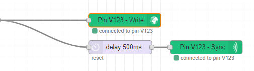

Simply write the data to the pin, then after a delay do a sync on that pin. The 500ms I’ve used is an overkill though I think.
And this is how the Sync node is set-up, just in case you really did mean that and not the Bridge.
