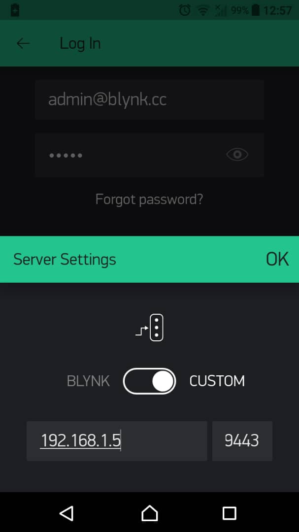

my app version " 2.27.12
I get tokan and put it on the Sketch.
My app connect to local server with ip and port.

Was your Auth token generated through the app when it was logged-in to your local server, and did you copy/paste it directly from the email into your sketch?
Auth token generated through the app when it was logged-in to my local server.
copy it and paste to sketch
